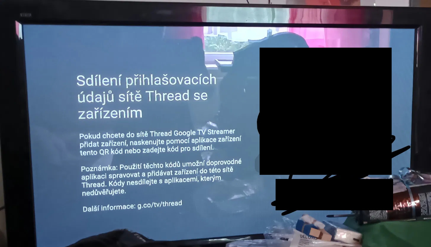

you need to go to the wifi settings and scroll down or use the home assistant app and inport the credentials more information is on Connect Thread smart devices with Google TV Streamer (4K) - Android - Streaming Help but there isint how to add it to hass or how to get to the screen i have in the picture
