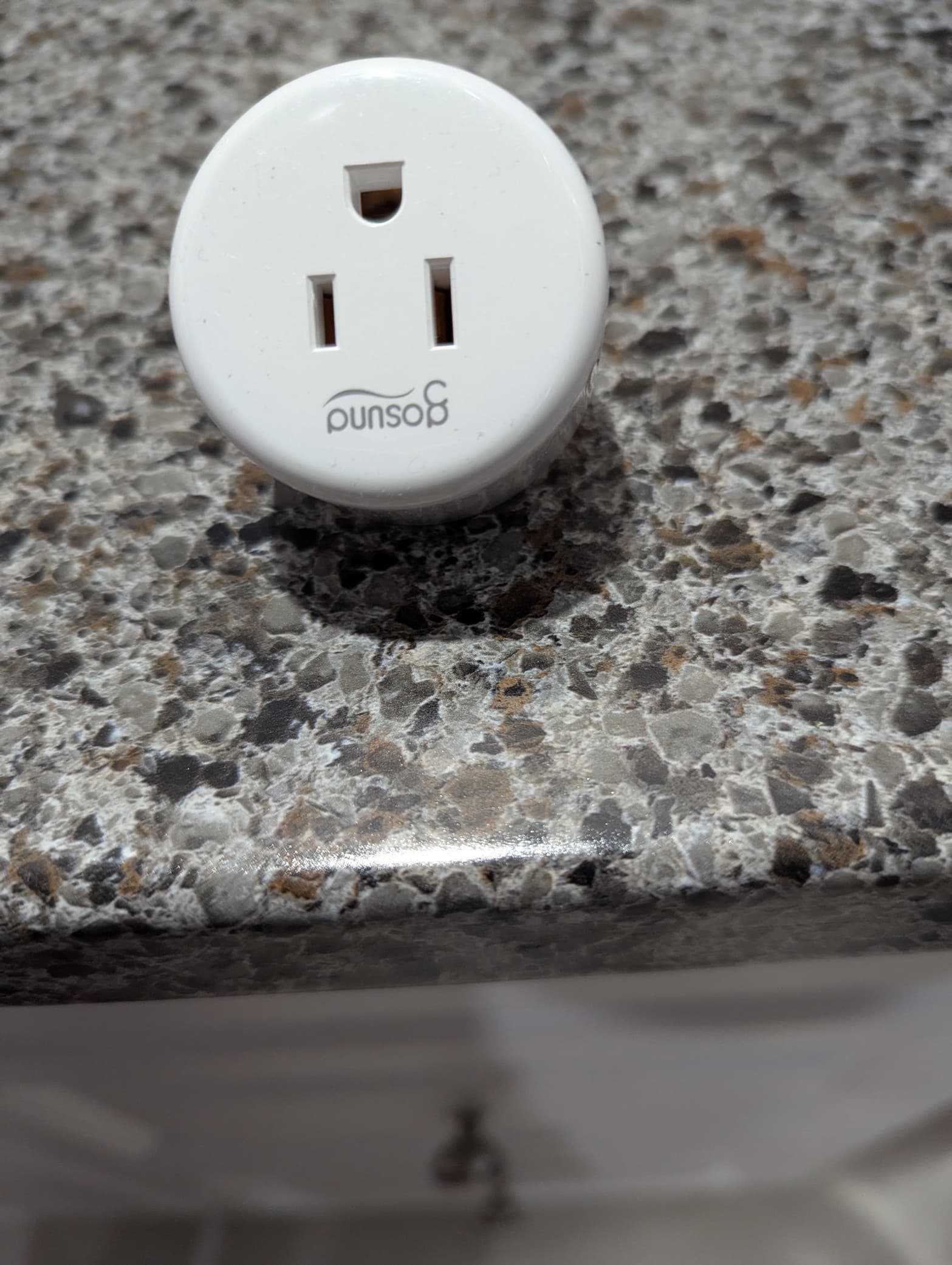

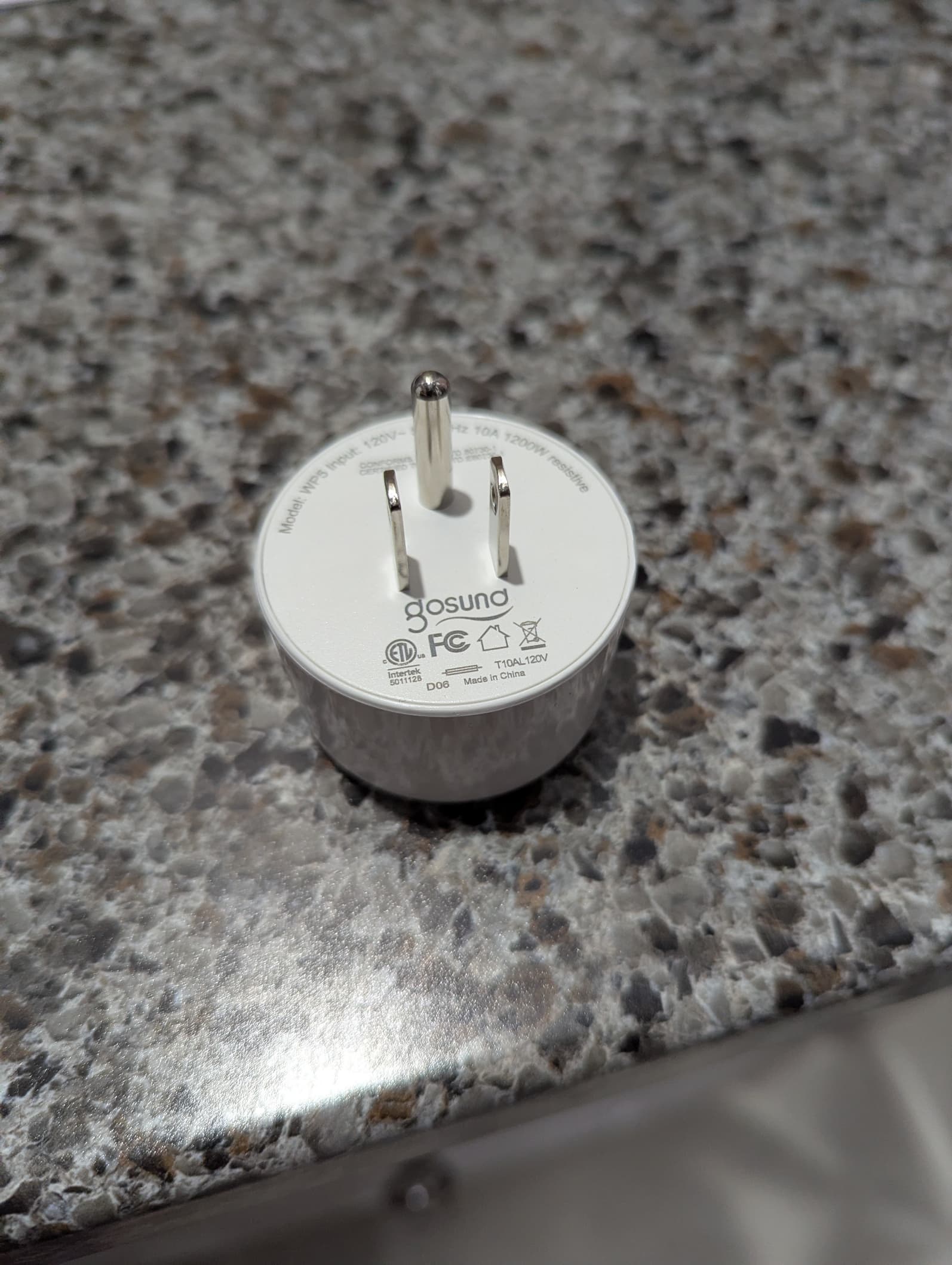

I have a bunch of Gosund Smart Plugs that I’m trying to flash using Tuya Convert. The issue I’m having is the plug seems to go into pair mode - rapidly flashing blue light - however shortly after starting the flashing procedure it will turn to a solid red colour. Next step is to hold the power button down for 5 - 10 seconds until I see the rapidly flashing blue light. Again the same result. I suspect these have a firmware that doesn’t allow flashing. I bought them some time ago.
Can anyone advise me if these can be flashed and how to they do it? Perhaps I’m not getting the device into pair mode correctly - flashing blue light? Is there a way to open them up flash it using something like Tasmotizer. I’ve included pictures for reference. Thanks in advance for any help that can be provided.
Hello Michael,
If you bought these plugs after 2021 or so, Tuya Convert will not work.
