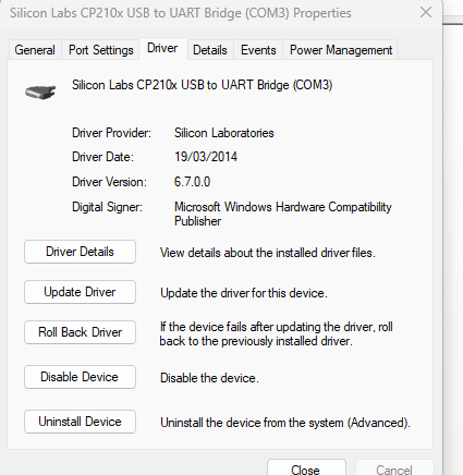

Try to install the CP210x USB to UART Bridge Virtual COM Port (VCP) driver:
The only way I could get to the dongle via windows was when ensuring I used driver version
19/03/2014 then it worked!
Then I could update the firmware and flash the Sonof Dongle E (old) GBL firmware onto it and it seemed to work the router dongle firmware was here : Sonoff_Zigbee_Dongle_Firmware/Dongle-E/Router at master · itead/Sonoff_Zigbee_Dongle_Firmware · GitHub
