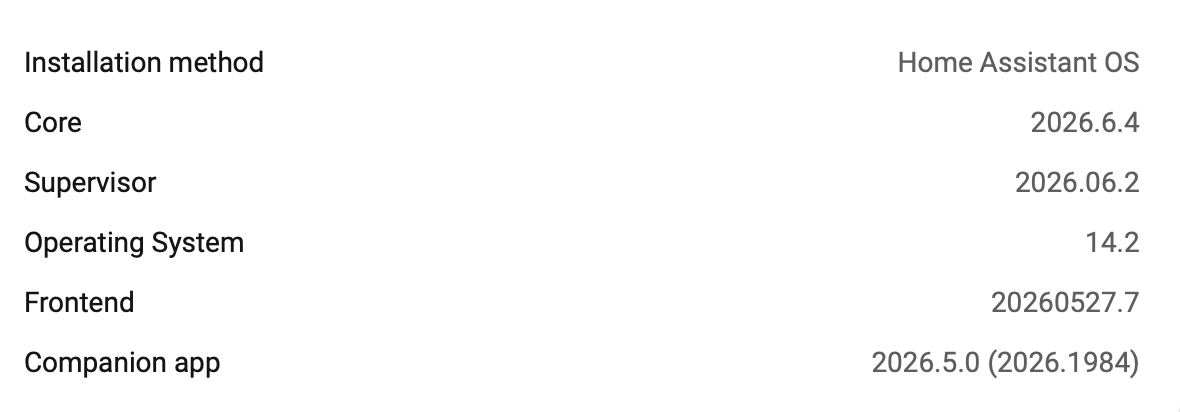

Got this message after last HA update - Unsupported system - Home Assistant OS version
My system is up to date as far as I know.
I regularly take the updates each month.
The OS received an update today to v18.0. I'm assuming that core doesn't like that you didn't update the OS.

You are a long way behind on OS updates.
This is the first time I knew about another layer of HA that had to be updated......
I installed this mini PC ages back, and it has always had two 'streams' of updates.
But the operating system ? its never said to do that. I pasted this int o AI just now and it said to issue this command from the terminal - ha os update --version=18.0
I just did that. Now Im thinking I should have picked something a bit close to the 14 I had....... HA is down, and not come back..... yet.

and its all back - bit of an anti climax. How do I get advised that these things even exist to update too ? I cant have missed all these ?
