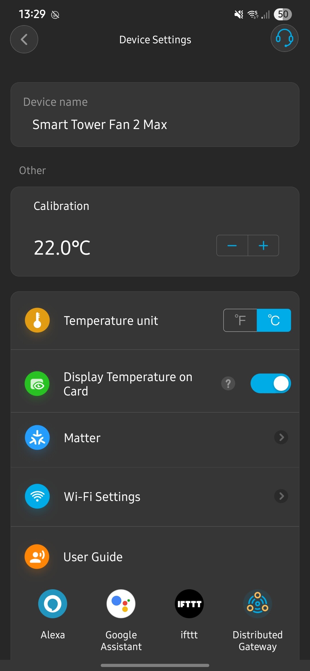

Where/how did you find the matter code for the H7107?
I got the prompt but couldn’t find a QR code on the device/box/manual anywhere, nor anything relevant in the app.
My fan came with a really small (5 x 5cm) instruction book for matter. It pointed me to the device settings menu where there is a Matter menu.
