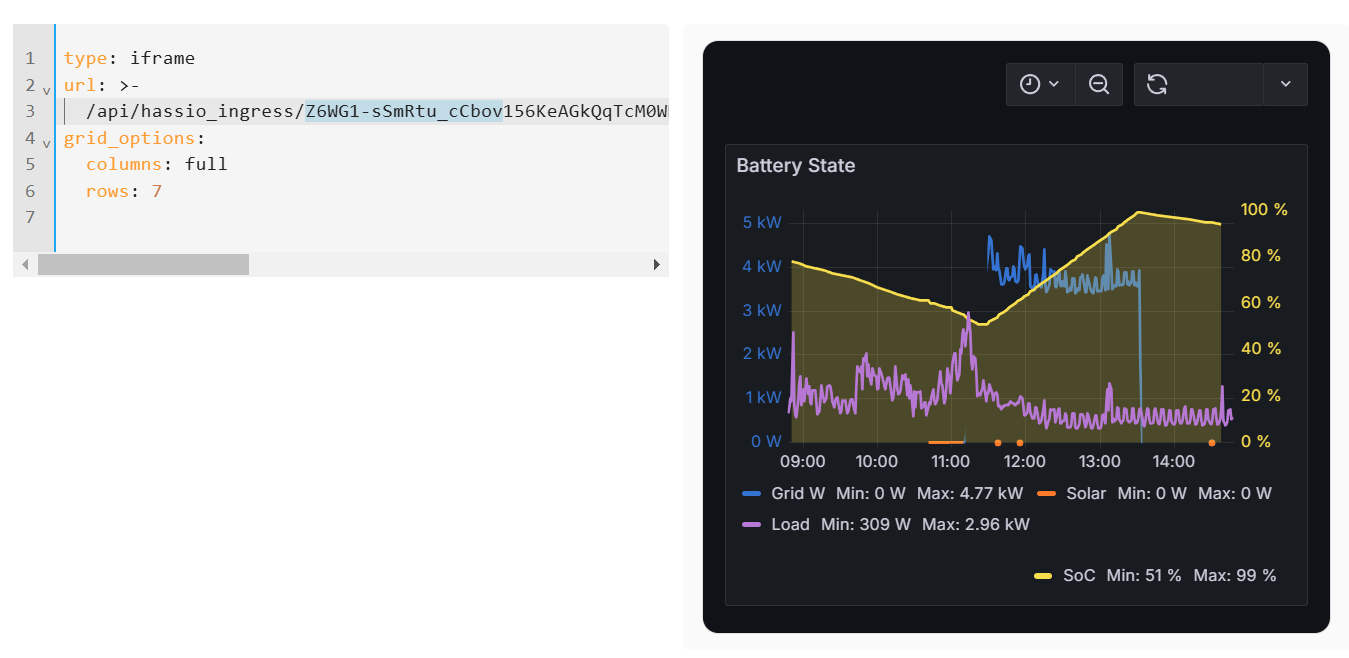

I got grafana to work in home assist through cloudflare… this way…
Assuming you already have cloudflare working with HA… and you have ingress turned on in grafana (which is the default if you install grafana these days)
  1. go to grafana in HA
  2. go to dashboard
  3. select a panel and click on its three-dot pulldown and share
  4. select either link or embed (with link you can get the ability to change the timeframe from your remote access of HA) (with embed you only get the panel, no controls).
  5. Turn off the “lock time range” switch
  6. copy the link provided
  7. Go to the dashboard in HA that you want to add the grafana panel to
  8. add webpage card.
  9. edit webpage card… NOW HERE IS THE SIMPLE MAGIC…
    When you paste the link, remove everything up to “/api/hassio_ingress” and if using embed, remove the extra settings at the end and the . Add &kiosk to the end if you like. So your url should now look like this…(fake data)
/api/hassio_ingress/Z6WG1-sSmRtu_cCbovAGkQqTcM0Walskdlasjdflg/d/aecdsb92pu3uob/inverter-battery?orgId=1&from=now-6h&to=now&timezone=browser&viewPanel=panel-3&kiosk
