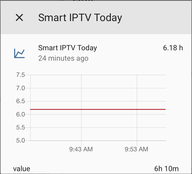

And they are looking good on Home Assistant:
(Looks like our guests left the TV on and fell asleep )

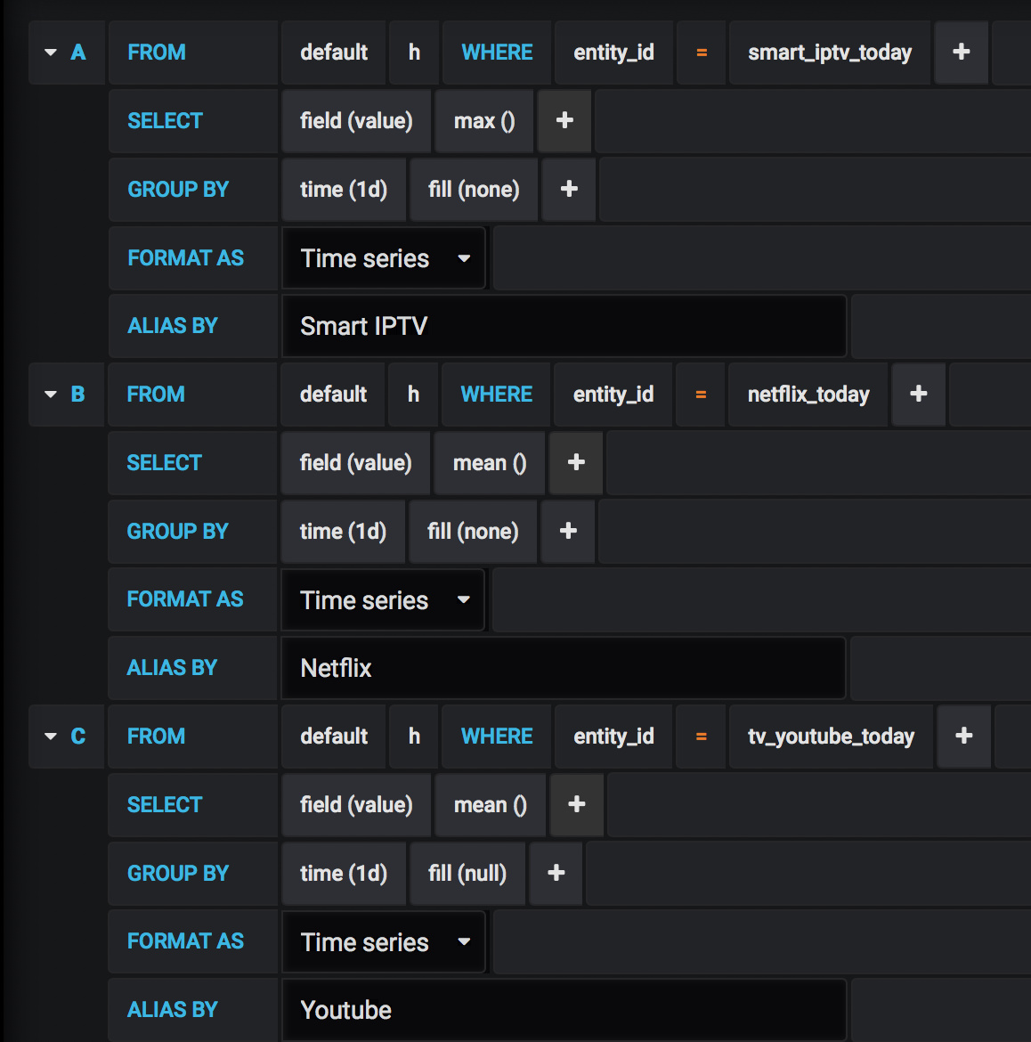

On Grafana I have created a table using these settings:

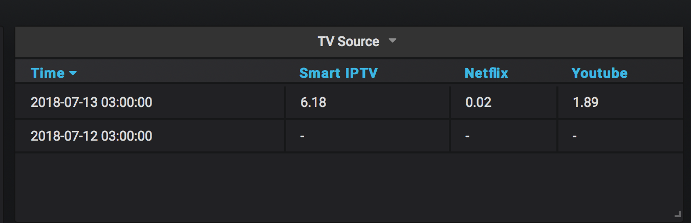

And I am getting this:
Now, the question is, why is the timestamp at 03:00:00 since at the time of writing this message it is 10:00 in the morning?

Weird thing, although values are being updated on Grafana, they are not the same (YouTube) as in Home Assistant and the Time remains 03:00:00

it’s probably reporting the start of the day in UTC.
EDIT:
I’ve never used graphina, but home assistant stores all time values in UTC. It reports all time values in Local. If graphina is using the raw values, then that’s your problem because the raw values are in UTC.
petro:
EDIT:
I think that’s the case, you are right. Now I guess I need to find how to set up Grafana to display the timestamps in my local timezone :}
