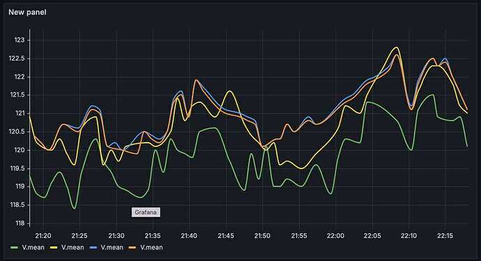

I’m trying to setup InfluxDB/Grafana for more advanced data logging (solar production/energy usage). I have InfluxDB working and recording sensor data, I have Grafana connected and was able to generate my first graph with no problems.
(tracking grid voltage fluctuations)

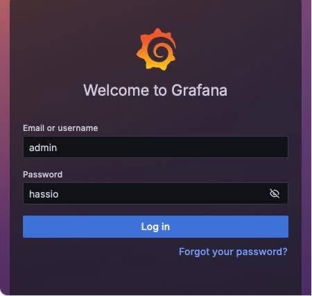

The problem started when I tried to add the graph from grafana to a lovelace iframe via the webpage card. The grafana login screen appears, I log in with the default admin/hassio, it flashes for a few milliseconds with green “logged in” before returning to the login screen.

I found the solution through days of banging my head against the screen. I was targeting the Grafana port in my url and needed to target the home assistant port.
