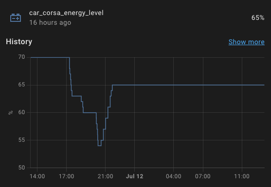

Hi, I have Home Assistant OS in virtual machines. I noticed, maybe after an update, that my sensors no longer show the history with the graph! (The same if I “show more”)
In configuration.yaml I have:
sensor: !include_dir_merge_list sensors/
The sensors folder contains several files. The sensors described in the files are correctly recognized, the configuration is correct and does not give syntax errors.
I have no space problems (24% used).
I show you some exemples:
The values written in the upper right corner are correct and update! But the graph is wrong.
I don’t remember if the problem started when I split the sensor.yaml file into multiple files and used a folder (which I included in configuration.yaml) or with an update.
Thank you
