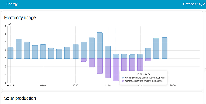

I’ve had some success in getting my electricity data consumption into the energy dashboard after forking and doing a bunch of re-work on the original repo. It’s still early days and a bit rough but it’s working. My green button provider lets me download the atom feed version of the ESPI xml, not a full xsd-compliant xml file - I have no idea if that’s what other providers supply so this may be a bespoke solution unless the atom feed format for green button data is used more commonly. Anyway, if you want to play with it, warts and all, it can be found at the rhounsell fork of the vqvu project (dev branch at the moment). You’ll have to copy/paste the actual xml into the XML field during the integration setup and then use the Import ESPI XML service/activity under developer tools to add subsequent XML. I’ve been focused on getting the data to display, but if things solidify this could probably be improved.
