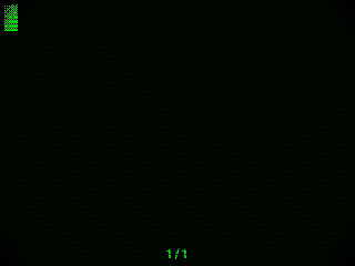

basic demo
The whole thing is intentionally soft and slow — closer to an early VT100 than a sharp modern OLED. There's a phosphor wash behind the text, a stippled scanline pattern, an optional Bayer-dithered corner vignette, a per-glyph bloom halo, and a brief afterimage when lines scroll off or the screen clears. The cursor and *emphasis* segments blink with a fade trail at the same rate.

sticky demo

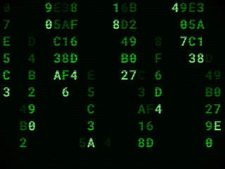

A "Sleep when idle" switch turns this into a strict power-saver: empty queue + switch on → screen blanks, backlight fades off, SPI flush effectively stops.
When switch is off, a "Matrix" style rain is displayed.
rain demo

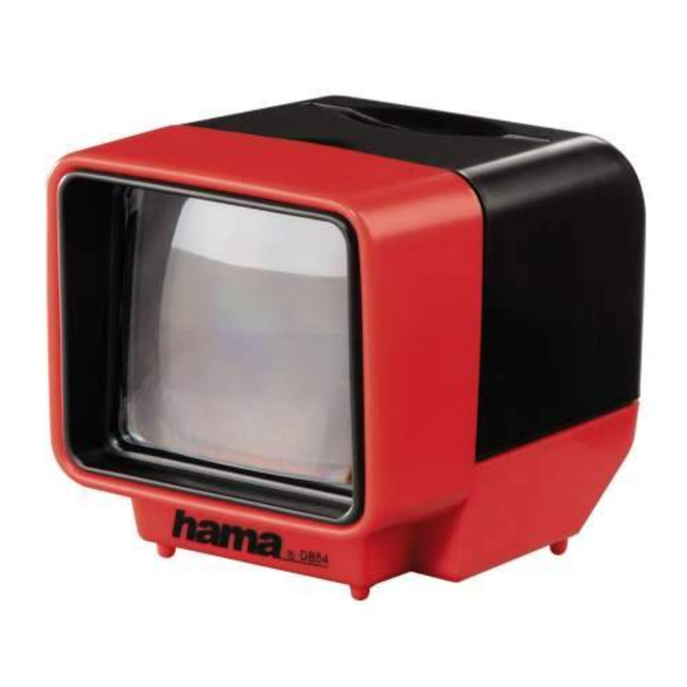

My Enclosure
I have installed my setup into an old mini slide viewer. The screen sits where the slide would when inside, and the LED strip sits above it so that the lights shine thru the slot where the slide would be loaded.
