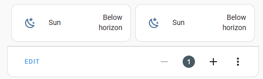

And this is what I see in Editor:

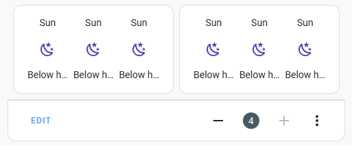

But not what I see in a view:
Observed in Chrome 131.0.6778.265 (Win10), FF 133.0.3 (Win10). iOS Companion App (iOS 15.x).
Have to define “50% 50%” explicitly - then it gives a desired effect:
Interestingly this glitch does not occur with Entities card:
And with Glance card:

The “auto” value works for Entities card, but not for History-graph.
