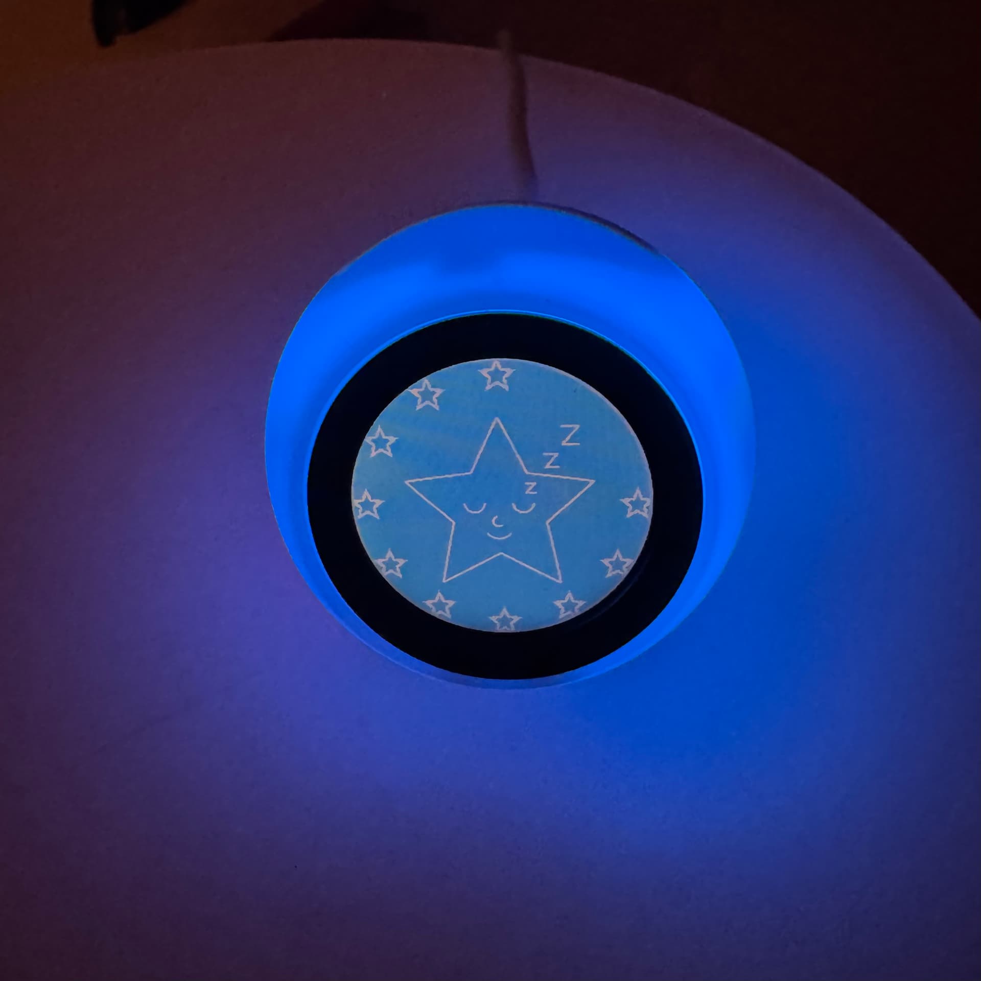

Just wanted to bump this to add that I received a Spotpear Ball today and have created an ESPHome config for it.
It has all the features of the Guition version (multiple sleep timers, star countdown, digital clock), plus ambient lighting and a media player.
It can be used entirely independent of Home Assistant as well, with the ability to stream audio from a supplied URL (for white noise or other sleep noises).

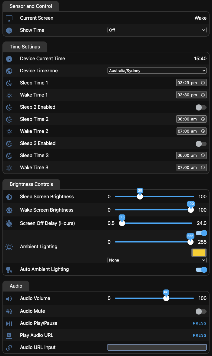

I’ve managed to get this working on a waveshare ESP32-S3-Touch-LCD-1.28 and it acts as it should, I’m no programmer so have no idea how complicated it would be, but any idea how I could change it to remove the pre-programmed sleep time and keep the preprogramed wake time. Ideally I would like to be able to start the sleep timer with an automation (RFID card read currently turns main lights off and starts a sound generator).
Happy to share the waveshare yaml if you wanted to add it to the git?
cheers
Hey mate, sorry for taking a month to get back to you!
Without making major changes to the ESPHome config, this should be possible using Home Assistant automations - set up a trigger (the RFID card read), and when the automation is run, change the sleep time to the current time.
Here’s a basic template for it:
alias: "Start Groclock Sleep"
mode: single
trigger:
  # Replace with your actual trigger (e.g., a dashboard button or NFC tag)
  - platform: state
    entity_id: input_button.trigger_sleep_now
action:
  - action: time.set_value
      entity_id: time.groclock_sleep_time_1
      time: "{{ now().strftime('%H:%M:%S') }}"
