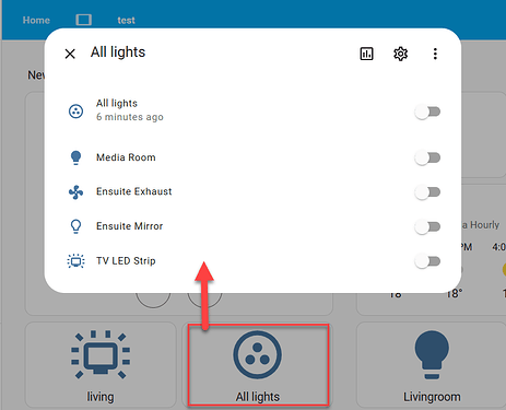

On my tablet wall panel I have a button (which is a group of lights, switches and fans), on tap it displays “More Info” with a list of all my entities. Is there a way to display all these entities not as switches but as tiles, I have a big list of devices, tiles would look nicer.
Or if there is a better way to do this? e.g. one of the options I have in mind is to setup another dashboard with all the required entities and my button will be a link to this dashboard.
You can show a stack/grid of tiles with a custom auto-entities card. These cards may be shown either on a subview or a popup (browser mod).
