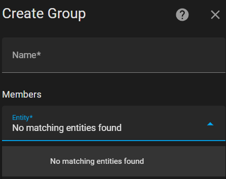

Im reading the documentation to try create a Notify group… and no success
[Notifications - Home Assistant](https://Link 1)
[Introduction | Home Assistant Companion Docs](https://Link 2)
Check the image.
The ideia is create a way to have just one user, and add many devices I need and just notify the user/person, as I attach also
Seems not possible reading the documentation, so we need to modify the configuration.yml
Its strange we cannot create this using UI

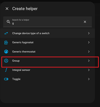

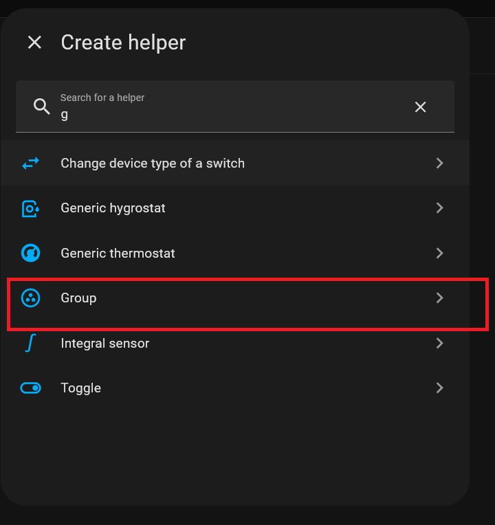

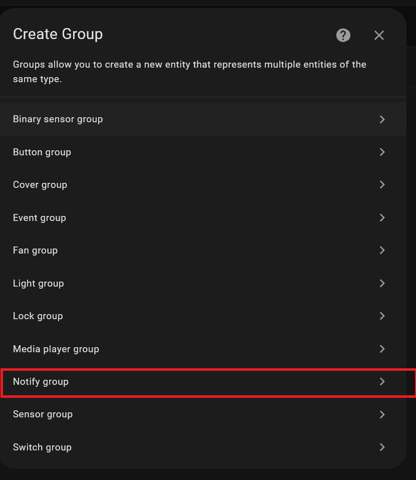

Start by creating a notifier group helper and remove that YAML group code from your config file.

Up to that point in your screen shots it looks indeed like this is the correct way to go about it, but the problem, and what the OP asked about, is that the targets do not show up in the drop-down. I have working notify groups with several devices in them that run the companion app, but …
The take-away: you have to define notify groups in your configuration.yaml and not in the UI, at least as of the latest versions of HA.
Nothing completely useful to add here, but I’ve had mobile groups in my config for the longest time, I got excited when i saw notify groups as a helper to eliminate code, but I also don’t see my devices in this group…or any entities for that matter. A bug maybe?
