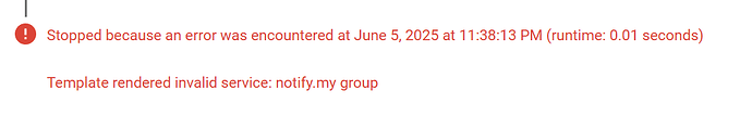

When you asked if it looked ok, I missed the fact that you don’t have action: in front of each of your actions :man_facepalming:
notify:
  - platform: group
    services:
      - action: mobile_app_adam_s_phone
      - action: mobile_app_stacy_s_phone
ok so progress, notify.my_group shows under actions now… I get that error in the trace from the blueprint
This is going to sound dumb, but reset your browser cache and then try to trigger the automation again.
:+1:
success, I did not have the underscore between my and group. Super picky on the way spaces are used from the gui and yaml code!!!
