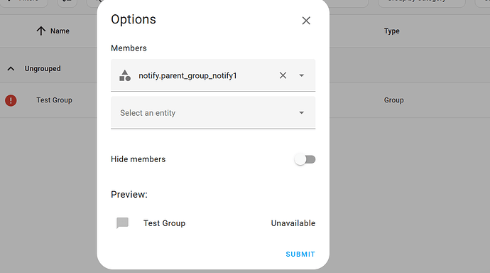

I’m stuck on this as well and don’t understand the solution. When I use the GUI helper to create a group, then select notify it asks me for members. Drop down showa select entity but when clicked it says no matching entities found. When I add device_tracker.phone_name it gives me an error it expected notify … when I use person.person_name it says expected notify @ date entities 0
I’m lost on this… I’m trying to accomplish the same thing you are sending out notification to multiple phone that a person entered or exited the zone using the zone extended blueprint.
belongs to domain person, expected [‘notify’] @ data[‘entities’][0] this is the error I get when I use person.person_name as the entity, what do I use as the entity to add to the group for the notification?
Check in your Entities menu to make sure you actually have notify entities. Since the Notify building block integration has been recently overhauled, most integrations for notifiers still do not create notify entities.
Instead, they create individual notify actions. These notifiers cannot be grouped using the GUI tool.

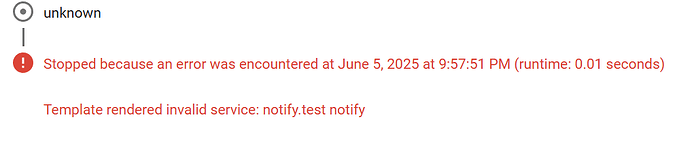

Yes, its the same Blue print. The goal is to setup a group to send the notification for the zone changes, I have everything working properly with the single device notification as far as blue print usage goes. Its the group notification I am struggling with. I think Im looking at it incorrectly as far as creating a group to message.
That’s what I have in the configuration file and the error above is what i get looking at the trace

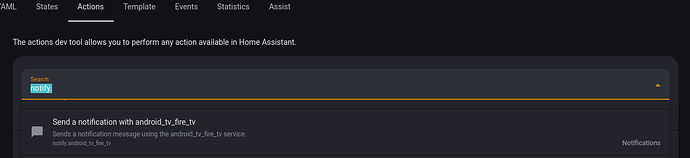

You will need to find all the notify actions you will be grouping. The easiest way to do that is in the Action tool. If you type “notify.” in the field it will give you a dropdown of all the notify actions available to you.
The information you need is the last line. In the following screenshot, “notify.android_tv_fire_tv” is the part you would note down:

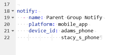

Does this look correct for the configuration.yaml file?

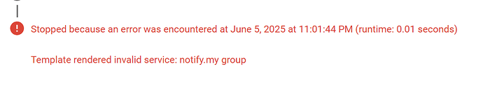

I must be missing something because this is what the trace says:

do i add this code somewhere in the config yaml file? with action and data?
The services are over-indented, but that’s not a critical issue.

  3. Go back to the Action tool and check that notify.my_group is now available.
It looks like the blueprint wants just the last part of the action ID, so for your example you would just type my_group into the text field for the notify_group input.
That’s one of the reasons why the base Notify integration was overhauled…
This is the part that is hanging me up, it does not show up, I restarted again. There was an error on restart that said group.notify couldn’t be set up. could it be the over-indented code?
