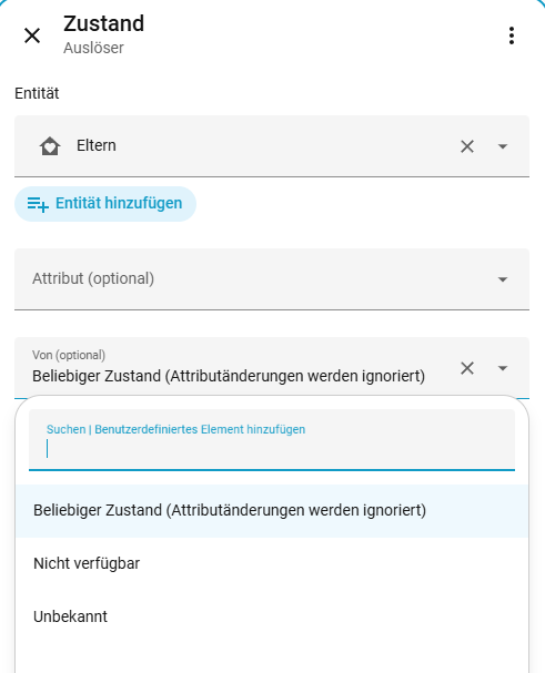

I want to run a defined action whenever two specific people are leaving my home. For this purpose I have created a simple group of persons with two members in my configuration.yaml:
group:
  parents:
    icon: mdi:home-heart
    entities:
      - person.johannes
      - person.patricia

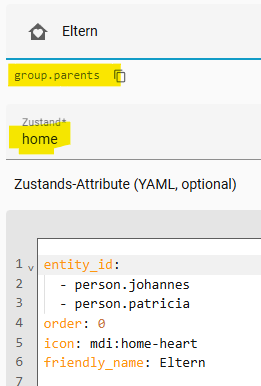

The group status is showing 'home. However, I can’t select ‘home’ in the from-definition of my trigger in an automation. I manually switched from home to away and back for each person, but that’s not changing anything.
What mistake am I making?

As I wrote, I can’t select ‘home’ in the UI, which looks like this: no 'home, no ‘away’
I can of couse check on combinations of the two persons’ states rather than using the group, but this increases condition complexity.

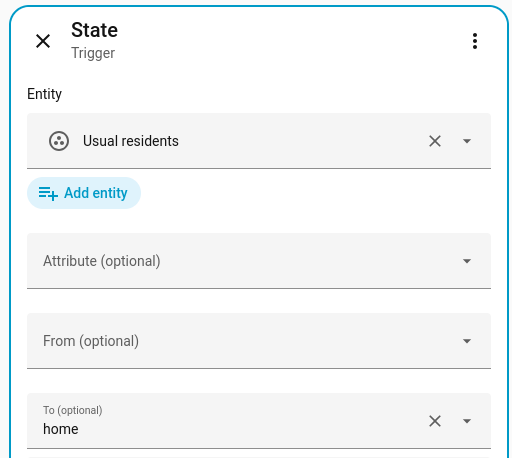

You can type “home” in though. The trigger dropdown cannot know all possible values of your sensor.

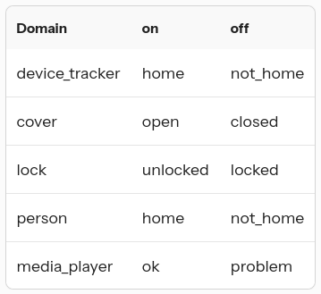

The group integration does not supply possible states to the automation/script editor like that. For a group of person entities the available states are home or not_home as shown in the following table from Integrations - Groups - Old Style Groups:

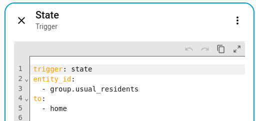

Or you could see my post above and supply the trigger home criterion by typing it in.
In the UI:
YAML view to make sure it’s worked:
