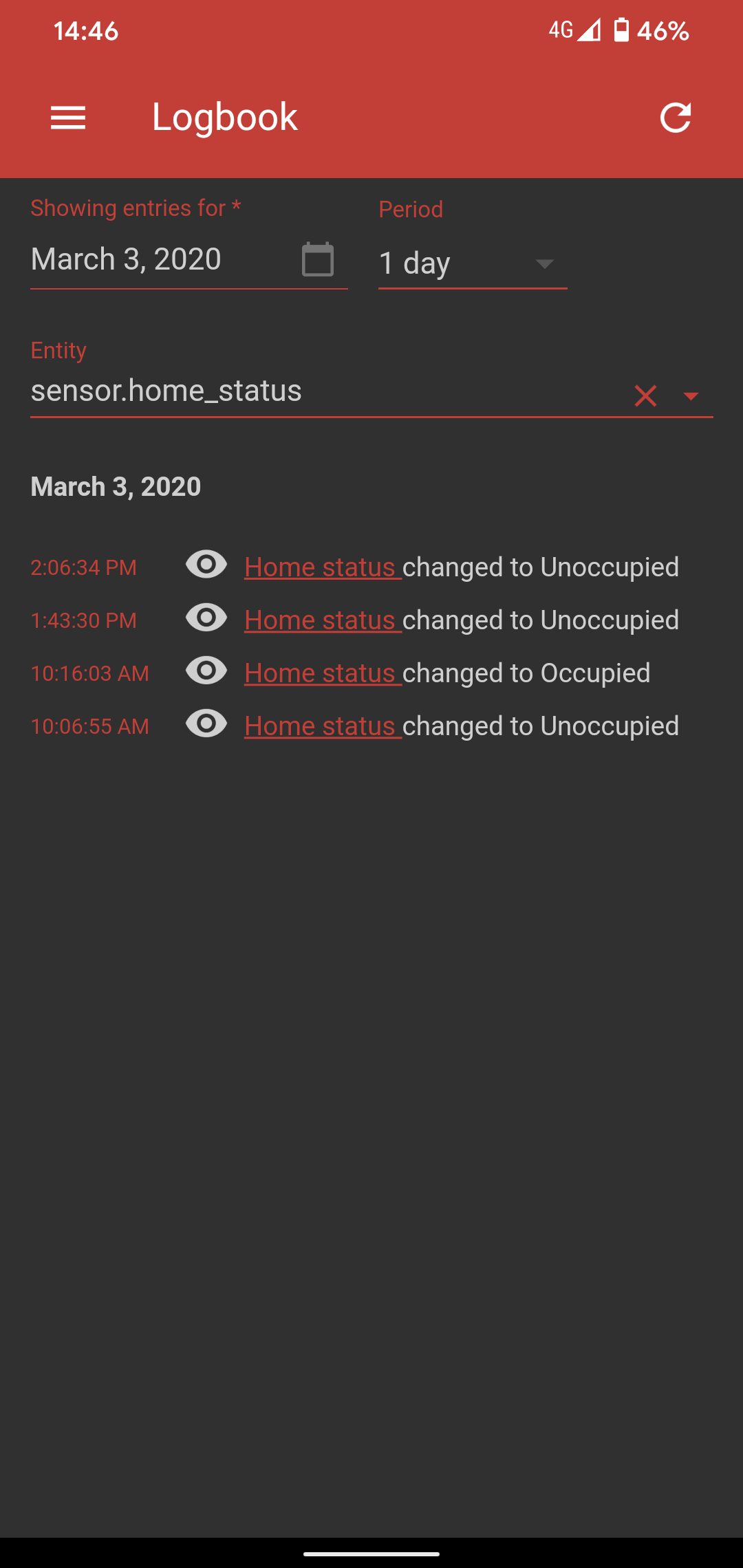

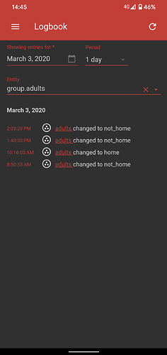

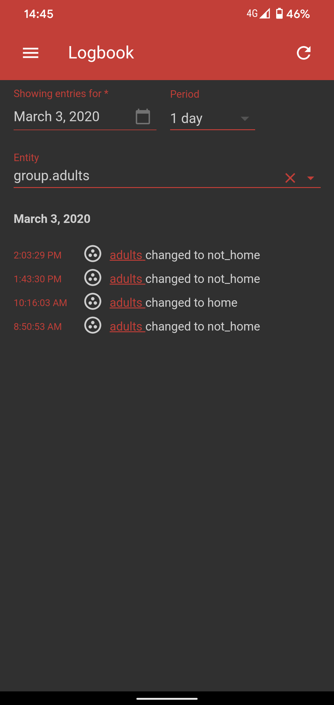

In fact I go a bit further and use those groups to define who’s at home (adults/kids/known guests) and an occupancy state for the house.

Yeah, so I create a sensor based on the values, so…
You can see from the screenshots that the last adult to leave home today left at 8.50, but the house isn’t marked unoccupied until 10.06 because one of the kids was still at home until then. After which they mirror each other as adults come in and go out again. The last update to both is because I remotely updated homeassistant and it restarted so the states updated.

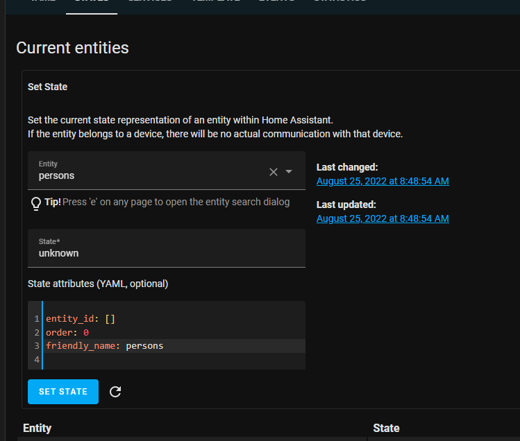

I’ve managed to create this person group but using it in automations is not possible. as there is no “home/away” state.
how do you use this with your automations? thank you
What state does the group have?
it’s just unknown
