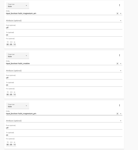

Within my automations, I have to add each input_boolean on it’s own and whenever I add a new “habit” I have to go back to multiple automations to add the new input_boolean.
Is there any easier way to scale this that I may be missing? All of them have “habit” in the name, is there some kind of scripting approach I could use instead?
Here is an example of part of 1 of the automations. I need to add a trigger for each input_boolean. Can these be grouped somehow?
Thank you very much!
