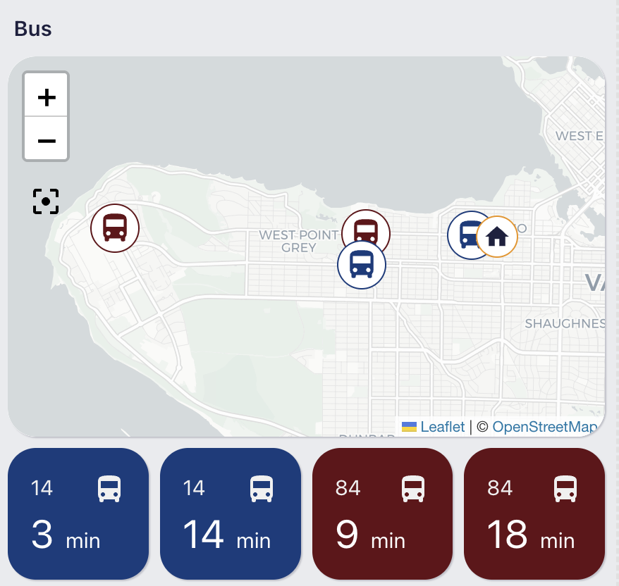

I’m currently implementing a new GTFS Real Time custom component to track transit in real time (there is a few available but all missing some features IMO).
My proposal includes the ability to get multiple sensors per line/stop to track the next services in real time, with a fallback to static data to supplement real time services.
Let’s say I want to track the next 3 departures for my stop: if only 1 is real time, it will fulfill the 2 others with static data.
I’ve been learning a lot for my first custom component implementation and so far I’m pretty happy with the results, real time sensors work perfectly.
