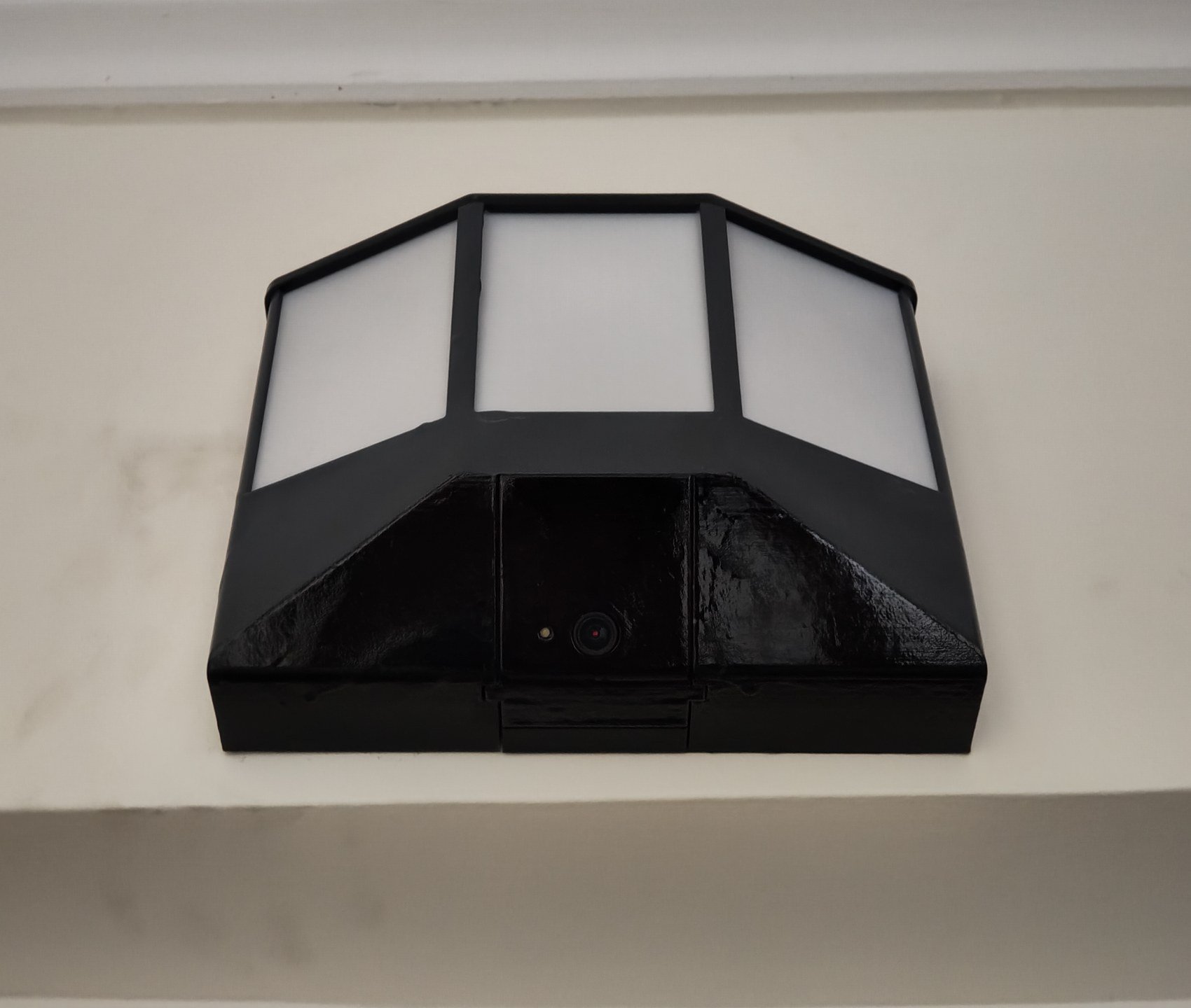

From the street this is a porch lantern. Inside the house it is the camera and the status lamp for a local Home Assistant door system I live with.
I am publishing the config tree, two ESPHome firmwares, and Gerbers. It is files that go into /config plus two ESP32 boards. It is not an add-on, not HACS, and not a product. MIT, as is.

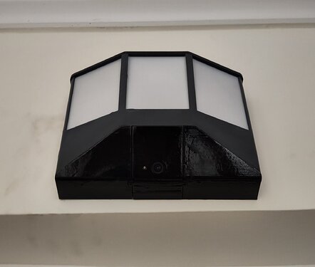

PETG porch lantern. Stripped Tapo C110 in the base, E27 Tapo L530E behind the panels. No custom PCB. From the pavement it is a lamp.

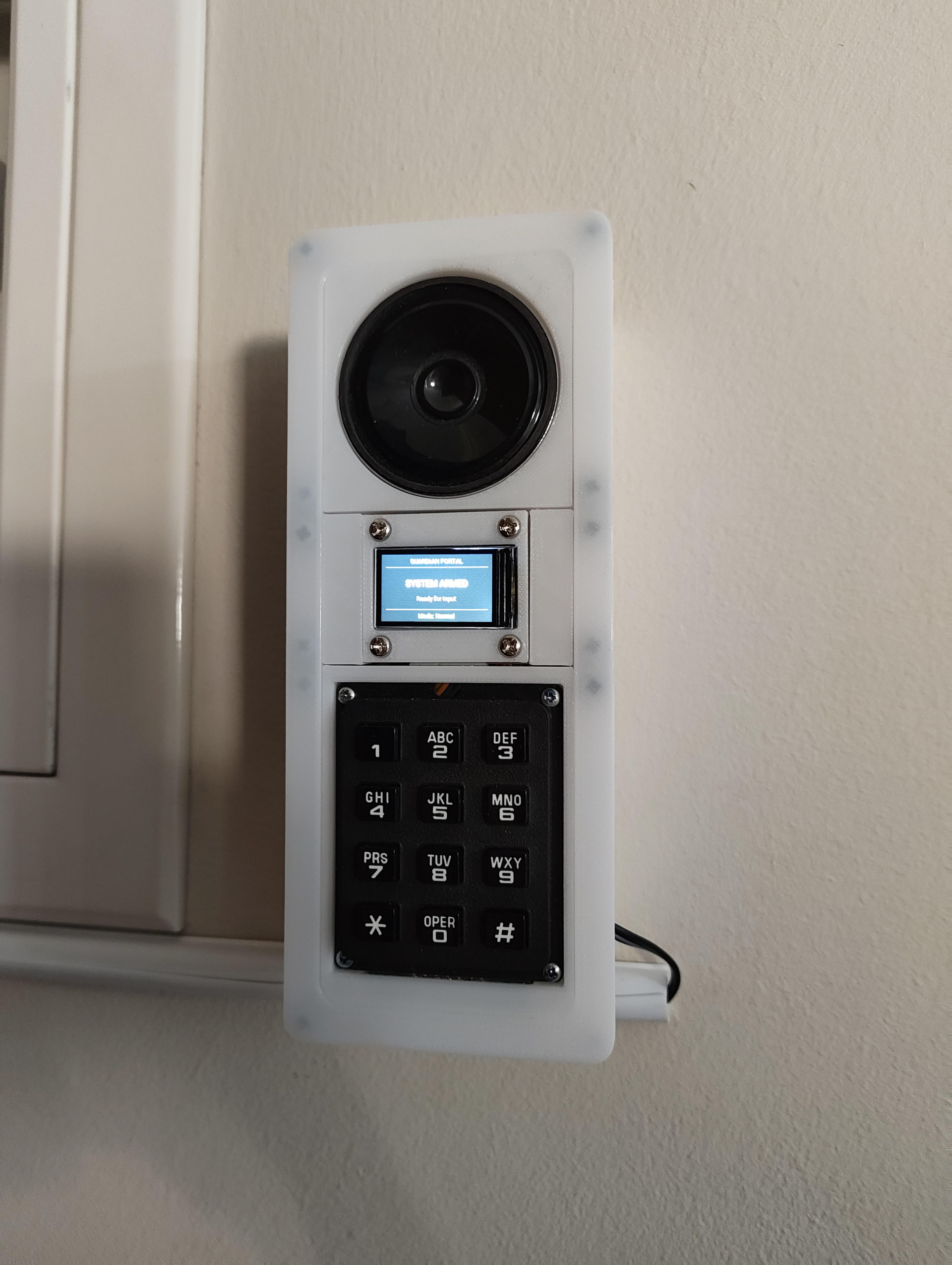

Interior portal on the wall: ESP32-S3, RC522, 4×3 keypad, 240×135 display, DFPlayer, reed, handle IMU.

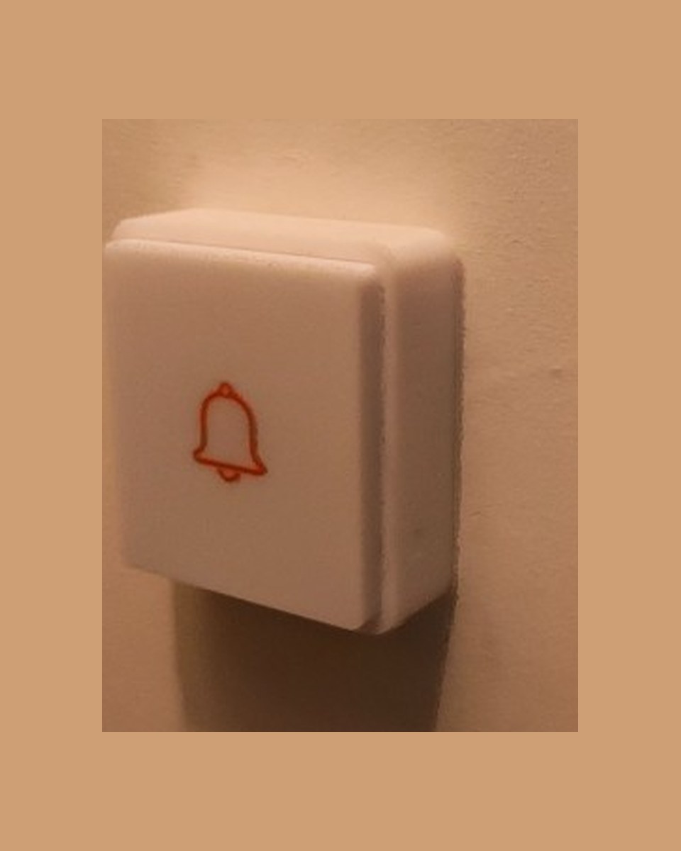

Outdoor doorbell: XIAO ESP32-C6, RC522, button. Same cards as the portal.

What decides. Every scan goes through one script. A valid tap opens a timed passage window. Direction comes from the lever IMU, the reader, and the door swing. The lantern follows measured camera luminance, with a sun-elevation fallback.
