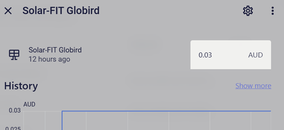

This one for example reset to zero - as did all the others. I only need to change it manually once a year when electricity tariffs change. I have some input number sensors in my configuration.yaml, but they have not been corrupted like this.

All the ones affected dropped to zero at 20:59 on March 29. My logs don’t go back that far and by the time I noticed (I don’t look at those sensors every day) it was too late.
Once I put the right numbers back into the Helper the templates seem to be working, but as I said I’ll convert all the GUI Input Numbers to YAML. It just gives me more control - Ditto with Utility Meters - I just think the GUI versions have too many limitations.
