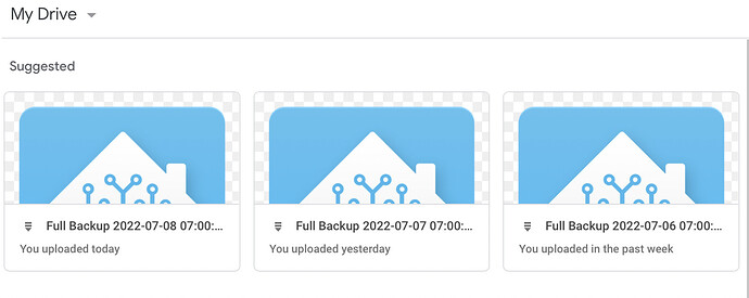

My backups seem to still work:

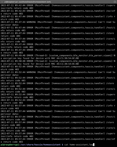

In the config folder you will find the HA logs. You may be able to get an idea of what is happening.
Did you by chance upgrade to 2022.7? There are a few ssl problems as a result. You can restore a snapshot from the command line.
@Mikefila thanks for the tip. I found the config folder and the logs look full of errors:
Trying to restore with the hassio command i get -bash: hassio: command not found.
Also my backups are in the google cloud and were probably overwritten with the bad configs.
Found a command that could work, but it doesn’t look like i have any backups?

I kinda fixed it. It was something in the configuration.yaml probably related to NabuCasa.
However now i can’t connect to NabuCasa and my Supervisior panel is not working anymore.
