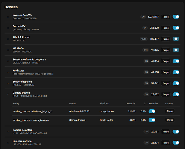

  • Per-device and per-entity toggles — turn recording on/off with a switch. No YAML.
  • Database statistics — see total / current / obsolete record counts, which entities are eating the most rows, disk size, and the DB path. Finally know what is bloating your database.

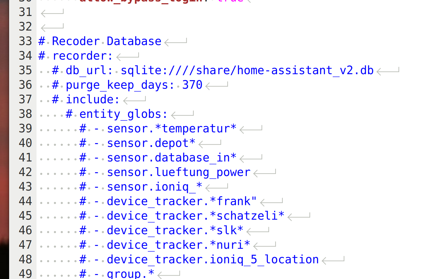

How is a separate recorder.yaml file handled when included via recorder: !include recorder.yaml in the configuration?
recorder.yaml is commented and gui_recorder.yaml is included in the config file with the configurator of the addon.

So here is an odd one Martin84:
GUI Recorder took over my “exclusion” from config.yaml
Except I did not work with exclusion, but instead only included - here a snippet:
While this worked quite well, I ran into problems when I just tried to start to get data into the recorder from a sensor that was installed BEFORE I installed GUI Recorder and was previously NOT on my include list,

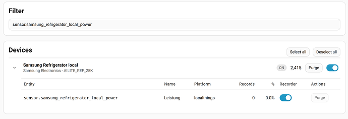

Despite GUI Recorder saying that it will do it - see picture:
… actually nothing happens.
I am currently unable to record a history of this sensor.
So my question - am I doing it wrong - and if so how to fix it.
Or is this maybe a bug?
