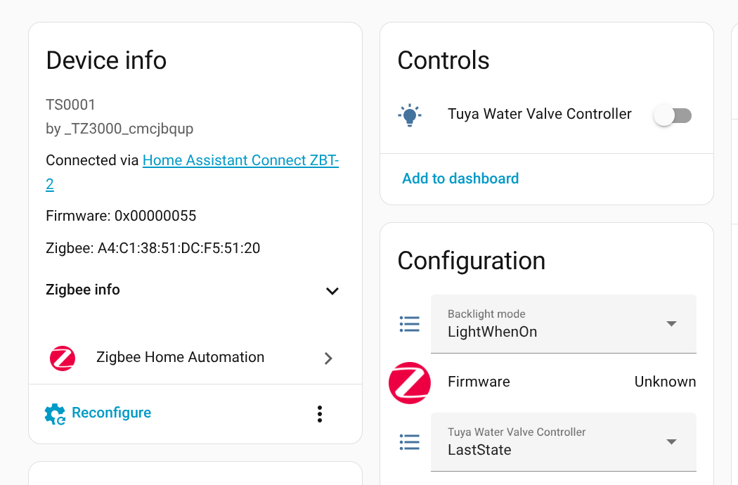

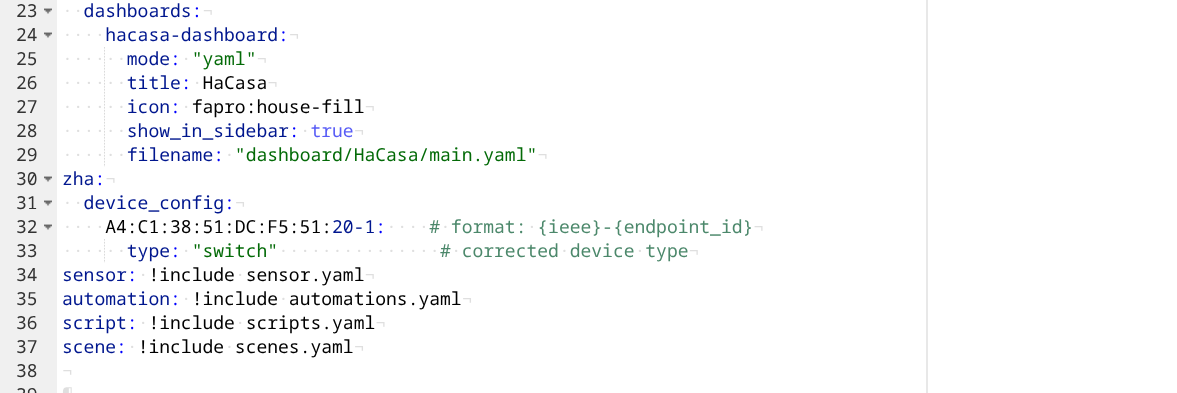

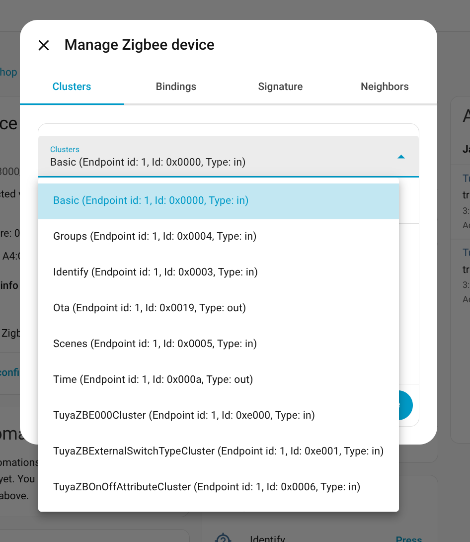

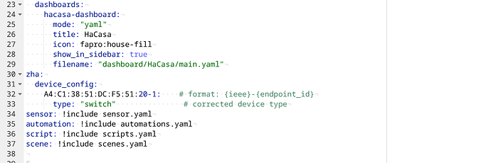

I know that I’m late to this topic but I can’t seem to get my Tuya Water Valve Controller that ZHA has identified as a light to be either a switch or a valve using this suggestion. I fairly sure that I have the correct IEEE id, I’ve restarted HA, and still no joy. I thinking that it could either be that I need to fully restart my HAOS system, put this zha: entry into another yaml file or move ahead with a template. Any suggestions would be appreciated - attached are screenshots of my configuration.yaml, the Tuya Zigbee details, and the ‘Manage Zigbee Device’ window.
I feel like it won’t (or shouldn’t) make a difference but try making all the letters in the IEEE lowercase in your configuration.yaml.
