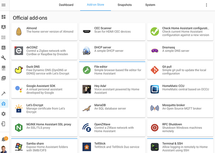

I don’t see the HACS terminal/SSH addon either, but I’m running supervised under debian/docker. Why do you need the HACS version?
There are no add-ons in HACs. You are confusing Home Assistant Community Store (integrations) with the community add-ons repo.
The community add-on repo is in the add-on store.
Thanks.
How do I install/access it?
