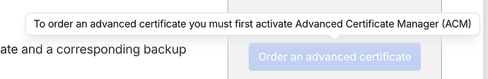

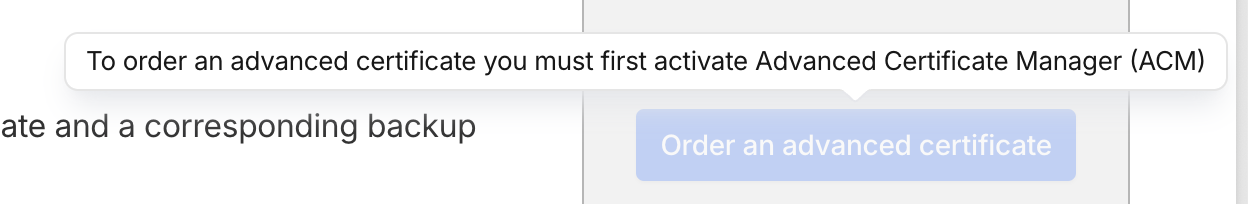

2.3 Ensure Your Hostname Has a Valid Edge Certificate
Have cloudflare changed this since your wrote it? It appears you need to pay $10 a month for “advanced certificate manager” now
I'll reword that section, it's a little confusing. Basically, you only need to order an Advanced Certificate if your clouldflare tunnel hostname for home assistant is deeper than *.yourdomain.com.
For instance, if your cloudflare tunnel hostname is ha.yourdomain.com you do not need an Advanced Certificate but if you want to use ha.home.yourdomain.com you will need an advanced certificate which then requires Advanced Certificate Manager and there will be a $10/mo fee.
