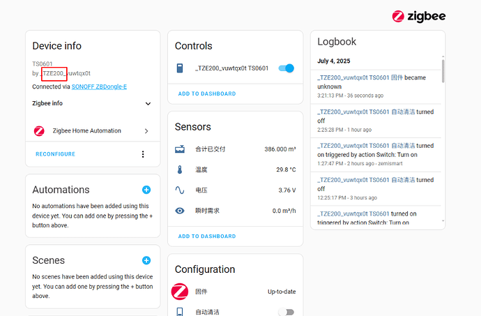

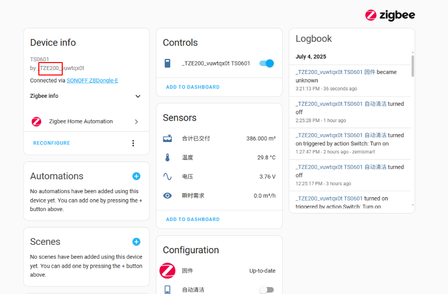

could your send some sceenshot to check?
sorry, did you try to change the name like this code?

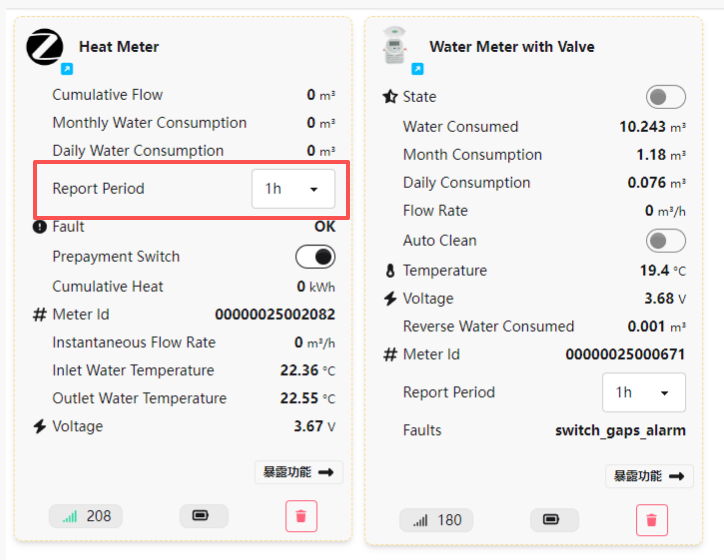

this is the page in Z2M, and the report period time is 1h

So the meter only report every hour to Z2M?
To use it as a leak detector can be a 1hr leak then if I understand correctly.
There is a “instantaneous” value, is that not the real instant value?
So it is recommended to use Z2M rather than ZHA ?
In comparison, Z2M offers more page features, depending on individual needs. The instantaneous value refers to the instantaneous flow rate at the moment of upload.

I tried ZHA with the 214C but didn’t get any values at all, after 1 day I only could turn it of and on.
Switched to z2m where I get more data

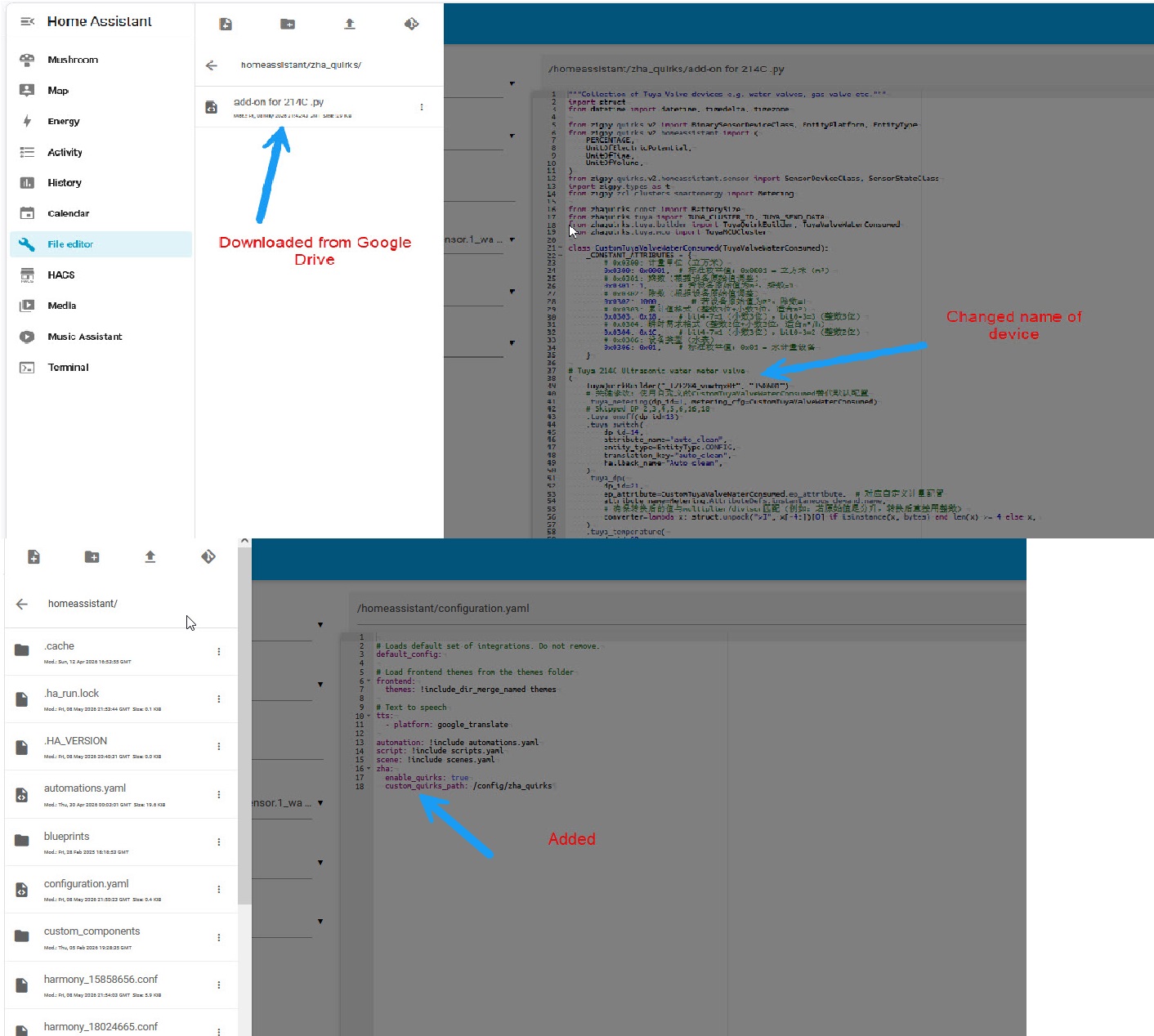

Hello, could you help diagnose the issue, here's what I have done:
I've downloaded the "add on for 214c.py", edited the name of the zigbee unit, and added the quirk path. I am still not getting data from the unit.
I appreciate all the help you can provide!
Thanks!
I am using Home Assistant and I do have a ZigBee 3.0 adapter - I confirmed the manufacturer's page.
