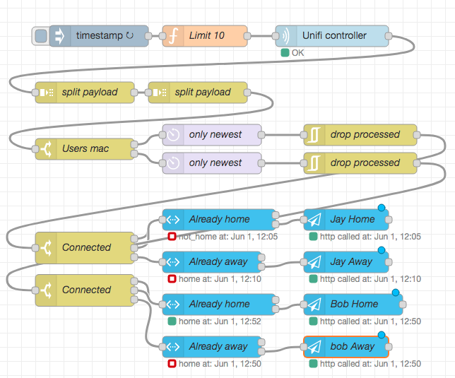

How it works
Ok, here is my flow. I also attached an image and explanation for others to easier understand. (For me it’s difficult to get an understanding just from the flow-code)
My thought was to get some presence detection that was using the alerts rather than what clients were on the network (of experience the reporting of what clients are on the network is not that good).
So I am polling the unifi controller every 30 seconds, but limiting the number of alerts to 10.
Then I have to split the payload since it is in two arrays.
Then I check and split on those users I am interested in.
Then I only allow new alerts to pass through, drop messages that has already been handled.
Then I check if the alert is about user connected or user disconnected from the network.
And lastly I update the person entity in home assistant.
I have written details on each node to help understanding.

This is working quite good, the update time is under a minute (from the device connects to the wireless network).
Also in my flows, I choose to use nodes instead of code. I know how to write code, but I feel it looks cooler with the nodes, and it can also be easier for non-coding people to understand.
Let me know if something is unclear (I’m also open for suggestions for improvement)
