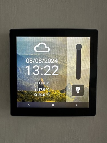

GUITION 4" 480x480 ESP32-S3-4848S040 Smart Display with LVGL
Works fine for me. How do you want to control it?
From HA dashboard card and from second page on the display with slider

I have a slider , but it’s doing nothing
Please help me with that issue. Thank you.

@Zenia : This is how I got it to work. the brightness has to be between 0 and 1 for the “local” light.
            - slider:
                align: bottom_mid
                height: 20
                width: 260
                min_value: 30 #anything below is too dark for me
                max_value: 100
                on_release:
                  then:
                    - light.turn_on:
                        brightness: !lambda return int(x)/ 100.0;
                    - lvgl.widget.hide: slider_pop
## Light
light:
  - platform: monochromatic
    output: GPIO38
    restore_mode: ALWAYS_ON
Can you give a link to the discord? Thanks)
It’s on the ESPHome.io front page - “Join the Community”
Thank you. It’s working now, and I found why mine was not working. I use different entity :rofl: :rofl: :rofl:. Should check everything twice. Thank you again

lvgl:
  displays:
    - my_display
  touchscreens:
    - my_touchscreen
  theme:
    #label:
     # text_font: roboto24 # set all your labels to use your custom defined font
    button:
      bg_color: 0x333333
      #bg_grad_color: 0x333333
      #bg_grad_dir: VER
      bg_opa: 85%
      border_color: 0x333333
      border_width: 0
      text_color: 0xFFFFFF
      pressed: # set some btn colors to be different in pressed state
        bg_color: 0x111111
        bg_grad_color: 0x111111
      checked: # set some btn colors to be different in checked state
        bg_color: 0x111111
        text_color: 0xf6ff00
    buttonmatrix:
      bg_opa: TRANSP
      border_width: 0
      pad_all: 0
      items: # set all your btnmatrix buttons to use your custom defined styles and font
        bg_color: 0x333333
        bg_grad_dir: VER
        bg_opa: COVER
        border_width: 1
        #text_font: roboto10
        pressed:
          bg_color: 0x111111
        checked:
          bg_color: 0x111111
          text_color: 0xEEEEEE
    switch:
      bg_color: 0xC0C0C0
      bg_grad_color: 0xb0b0b0
      bg_grad_dir: VER
      bg_opa: COVER
      checked:
        bg_color: 0x1d5f96
        bg_grad_color: 0x03324A
        bg_grad_dir: VER
        bg_opa: COVER
      knob:
        bg_color: 0xFFFFFF
        bg_grad_color: 0xC0C0C0
        bg_grad_dir: VER
        bg_opa: COVER
    slider:
      border_width: 1
      border_opa: 30%
      bg_color: 0x9c9c9c
      bg_opa: 15%
      indicator:
        bg_color: 0x333333
        bg_opa: COVER
      knob:
        bg_color: 0x444444
        bg_grad_color: 0x444444
        bg_opa: COVER
        border_color: 0x444444
        border_width: 1
  style_definitions:
    - id: header_footer
      bg_color: 0x444444
      bg_grad_dir: VER
      bg_opa: COVER
      border_width: 0
      radius: 0
      pad_all: 0
      pad_row: 0
      pad_column: 0
      width: 100%
      height: 40
  top_layer:
    widgets:
      - label:
          text: "\uF1EB"
          hidden: true
          align: top_right
          x: -2
          y: 2
          text_align: right
      - buttonmatrix:
          align: bottom_mid
          styles: header_footer
          pad_all: 0
          outline_width: 0
          items:
          rows:
            - buttons:
              - id: page_prev
                text: "\uF053"
                on_press:
                  then:
                    lvgl.page.previous:
              - id: page_home
                text: "\uF015"
                on_press:
                  then:
                    lvgl.page.show: clock_page
              - id: page_next
                text: "\uF054"
                on_press:
                  then:
                    lvgl.page.next:
      - obj:
          x: 0
          y: 0
          width: 100%
          height: 100%
          bg_color: 0x000000
          bg_opa: COVER
          radius: 0
          pad_all: 0
          border_width: 0
          widgets:
            - image:
                align: CENTER
                src: boot_logo
                y: -40
            - spinner:
                align: CENTER
                y: 95
                height: 50
                width: 50
                spin_time: 1s
                arc_length: 60deg
                arc_width: 8
                indicator:
                  arc_color: 0x18bcf2
                  arc_width: 8
          on_press:
            - lvgl.widget.hide: boot_screen
  page_wrap: true
  pages:
    - id: clock_page
      widgets:
        - image:
            align: CENTER
            src: back7
        - label:
            align: CENTER
            text: $happyface
            bg_opa: TRANSP
            text_font: weather_icons
            y: -160
            x: -75
        - label:
            align: CENTER
            text: date
            text_font: roboto40
            y: -80
            x: -75
        - label:
            align: CENTER
            text: clock
            text_font: roboto90
            y: -15
            x: -75
        - label:
            align: CENTER
            text: weather
            text_font: roboto24
            y: 70
            x: -75
        - label:
            align: CENTER
            text: temp
            text_font: roboto24
            y: 115
            x: -75
        - label:
            align: CENTER
            text: house temp
            text_font: roboto24
            y: 150
            x: -75
        - obj: # a properly placed coontainer object for all these controls
            align: CENTER
            width: 150
            height: 480
            bg_opa: 30%
            border_opa: TRANSP
            pad_all: 5
            x: 164
            y: 0
            widgets:
              - slider:
                  width: 30
                  height: 220
                  x: 55
                  y: 60
                  min_value: 30
                  max_value: 160
                  value: 160
                  on_release:
                    - number.set:
                        value: !lambda "return int(x);"
              - button:
                  align: CENTER
                  width: 80
                  height: 80
                  #x: 0
                  y: 120
                  checkable: true
                  widgets:
                    - label:
                        text_font: btn_icons_font2
                        text: $lightbulb
                        align: CENTER
                  on_click:
                    - homeassistant.service:
                        service: light.toggle
                        data_template:
                          entity_id: light.living_room_light_l1
                          brightness: !lambda "return id(dimmer_level);"

                        text: "Office"
                        long_mode: dot
                        align: CENTER
                        y: 30
                  on_click:
                        service: automation.trigger
                          entity_id: !lambda "return id(aut_office);"
              - button:
                  checkable: true
                  grid_cell_column_pos: 2 # place the widget in
                  grid_cell_row_pos: 1 # the corresponding cell
                  grid_cell_x_align: STRETCH
                  grid_cell_y_align: STRETCH
                  widgets:
                    - label:
                        text: $radiator
                        align: CENTER
                        y: -20
                    - label:
                        text: "Kids"
                        long_mode: dot
                        align: CENTER
                        y: 30
                  on_click:
                          entity_id: !lambda "return id(aut_kids);"
