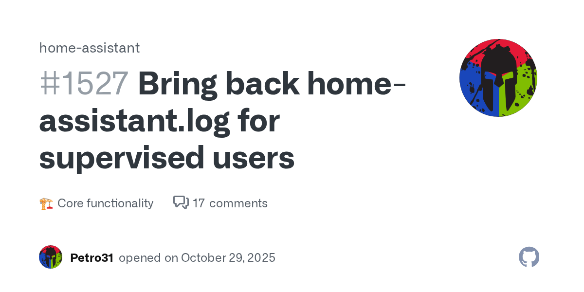

you of course are fully aware that is not the actual ‘need’… and not what poster expresses his worries about. It is this:
btw, check here for many reasons, and still no solutions but half baked workaround
