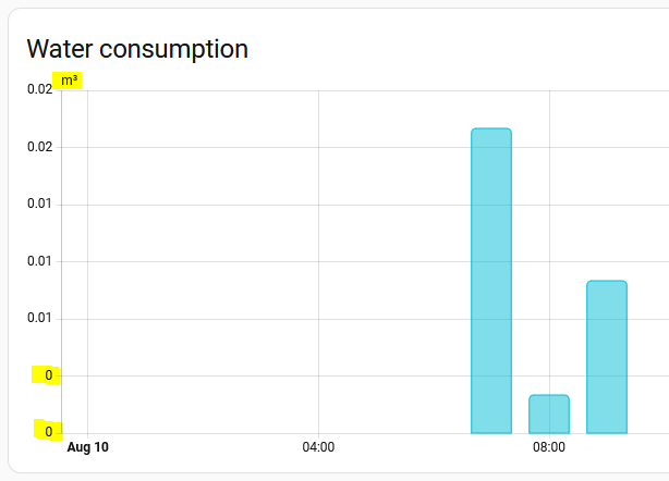

I just found out that the water usage unit on the Energy Dashboard is changed, probably since installing HA 2025.8.0 It now is in m3:

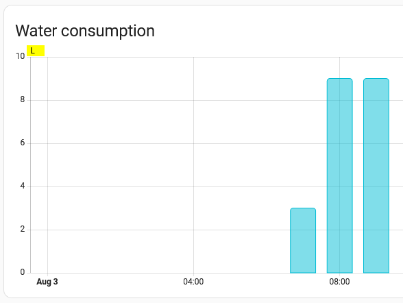

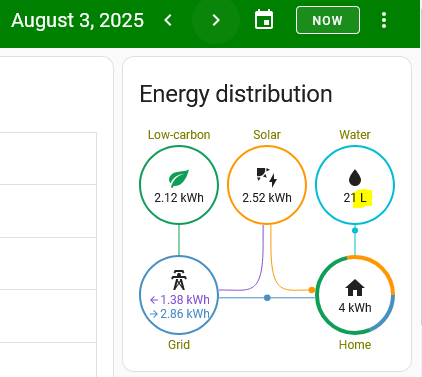

This has always been in Liter:
This is really a step backwards as it is less accurate this way, especially with only two decimals. The resolution is +/- 10 Liter like this.
