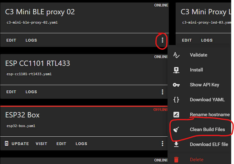

Did you try cleaning the build files?
Yes it’s the ESPHome addon running on HAOS (which also just upgraded to 16.1). How does one clean the build files?
