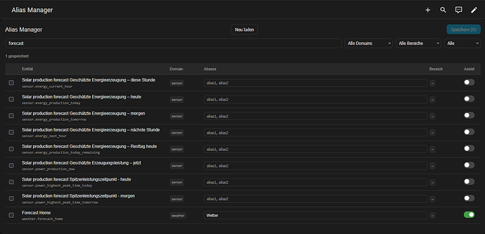

I built a custom Lovelace card that solves this with a spreadsheet-like interface.
What it does
HA Alias Manager gives you a full table view of all your entities where you can:
  • Edit aliases directly in the table (comma-separated)
  • Toggle Assist exposure with a single click
  • Filter by domain, area, Assist status, or free-text search
  • Save all changes at once with the bulk save button
  • Reload the entity list without refreshing the page
![Screenshot showing the HA Alias Manager with a table of entities, alias input fields, and Assist toggles]
