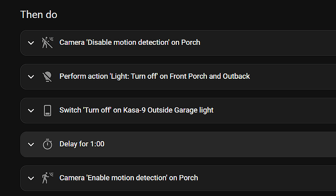

I’m going to give this a try:
I found an even better solution. There’s an amcrest integration for home assistant. I can directly enable/disable motion detection since in-camera is where I’m detecting it not surveillance station…
You can also send the notifications through HA to your companion app: Synology - send System Notifications to Homeassistant & Companion App
Depending on your automation conditions you can let the notifications through or not.
Still not working… even when I use the Amcrest integration and disable Motion Recording prior to turning lights on/off, my Surveillance station still captures “motion”… so I’m at a loss…
You’ll need to look at the camera setup in surveillance station. Is it using camera events and/or doing detection on its own?
Yes… all of the motion detection happens in-camera… what’s odd is the Amcrest integration allows me to Enable/Disable motion recording… i can confirm the “check box” in the camera goes on/off via the integration, but it seems the camera just sends the detection to Surveillance station anyway as I keep getting the alerts.
