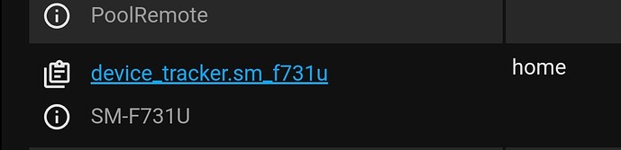

I want to use the device tracker on my ZFlip for some automations. But whatever I do the device shows always “home”. When I check the phone’s “geo location sensor” it shows the correct place where I am at right now. I am using Nabu Casa for my remote access.

This is what the tracker shows:
Whatever the standard is, 100 meters or so? Right now I am 2.500mls away from my home.

It is showing the place where I am right now: Coronado, CA, 2.5k MLS away from home:
ok then you may not be looking at the correct device tracker entity as th app is sending data back home that is correct.
double check the entity and if you are using the person entity check what devices are assigned to it, sometimes if you login to a tablet that never leaves home it conflicts.
I am using the person entity and SM-F731u is assigned to the person entity for tracking.
I also had assigned the correctly working tablet to the person for tracking and that worked.
Just my cell phone doesn’t work.
if that entity is not showing the correct location as the screenshot you sent which showed successful updates then you are not looking at the correct device tracker entity. The app is showing updates are accepted by the server so there is indeed a device_tracker entity that usually takes the name of the device you assigned.
if you go to settings > devices and services > mobile app > select the device you logged into and you will see the correct device tracker entity there
Yup! Here seems to be the problem … There are 3 “integration entities” for the same phone instead of one.

Success!
I deleted the wrong ones and now my person is being tracked by the correct entity.
Interestingly on of the wrong entities was easy to delete the other one wouldn’t go away. So I deactivated it.
