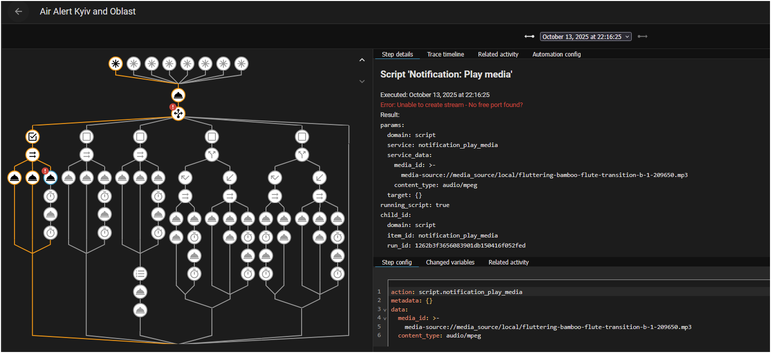

Error: Unable to create stream - No free port found?

UPD: No luck! I’ve solved the cutting issue, but cannot catch, reproduce and solve the issue with players in automation. It just randomly happens.
logs
2025-10-13 22:16:26.205 WARNING (MainThread) [music_assistant.snapcast] {'code': None, 'message': 'Server not connected'}
2025-10-13 22:16:26.205 ERROR (MainThread) [music_assistant.webserver] Error handling message: players/cmd/play_announcement: Unable to create stream - No free port found?
2025-10-13 22:16:31.215 INFO (MainThread) [music_assistant.snapcast] Stopping, built-in Snapserver
To recreate: Failed to perform the action tts.speak. Unable to create stream - No free port found?

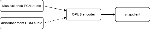

So I studies Snapcast source code and I think I found the root cause.
  • The snapserver encodes and sends audio to clients as fast as possible, there are no large internal buffers there.
  • The playback delay is controlled entirely by snapclient. It receives WireChunk and CodecHeader messages. WireChunk messages contain the timestamped encoded audio data and are added to a buffer for later playback after a delay. CodecHeader messages are processed immediately and clear the internal buffer and reset the player state.
  • The issue is that the codec is set per snapcast stream and not globally. Each stream has its own encoder instance. When MA switches stream, a new CodecHeader message is sent and processed immediately and that clears the buffer in the client.
On MA’s end, we could inject the announcement into the currently playing stream’s audio data and not create a new stream. But this would mean that when multiple players are grouped together, the announcement could be send only to the entire group, not to individual players thereof.
On Snapcast’s end, I came up with two solutions:
  • Either modify the snapserver, so it shares the encoder between multiple streams if they have same parameters (codec, sample rate & format etc.). When switching streams, switch the encoder input instead of the encoder output.
    Current situation (switching encoder output):
    Desired situation (shared encoder, switching its input):
  • Modify snapclient so it doesn’t reset the player when receiving the CodecHeader message, but just starts decoding the new data and queuing it to the player like normal. This would be only possible if the decoded data is compatible (same sample rate & format), otherwise it would behave like currently.
