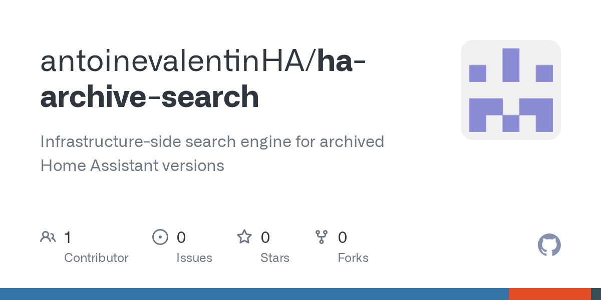

Ha-archive-search — Search and Markdown export for archived Home Assistant versions
Hi everyone,
A few days ago I posted ha-state-archive, an infrastructure-side archival and audit pipeline for Home Assistant snapshots.
While building and using that archive corpus, I ended up developing a second companion project focused on historical exploration and search:
ha-archive-search
Repository:
What it does
ha-archive-search is a multi-platform search engine operating on archived Home Assistant versions stored outside HA itself.
The project currently provides:
  • bounded recursive filesystem search;
  • version-aware traversal (--latest, --version, --all-versions);
  • compact or context search modes;
  • documentation filtering;
  • Markdown export;
  • lightweight Flask web interface;
  • Docker deployment;
  • LAN/VPN browser access from desktop or mobile devices.
The search corpus is the archive structure produced by ha-state-archive, but the project itself is filesystem-oriented and does not depend on Home Assistant internals at runtime.

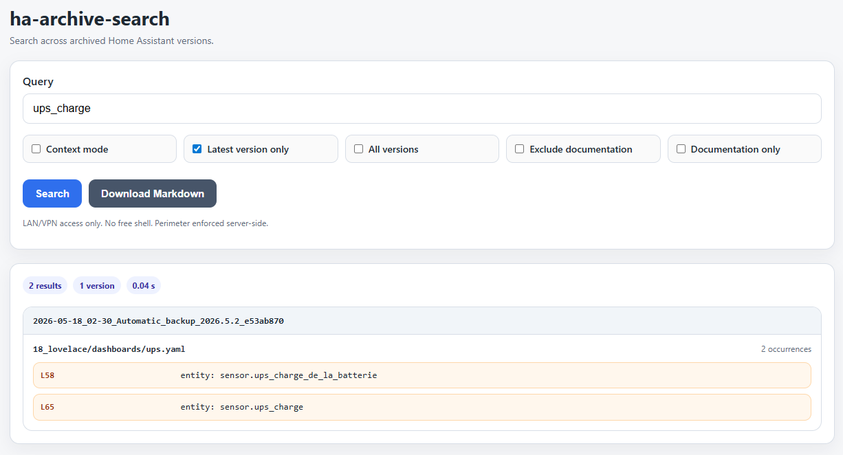

Current examples below.
Compact search UI:

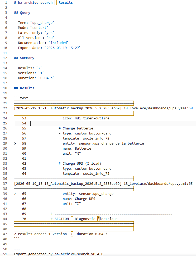

Structured Markdown export (context mode):
The context export workflow is becoming especially useful for:
  • audit reviews;
  • documentation workflows;
  • configuration inspection;
  • AI-assisted analysis;
  • portable technical reports outside Home Assistant runtime.
