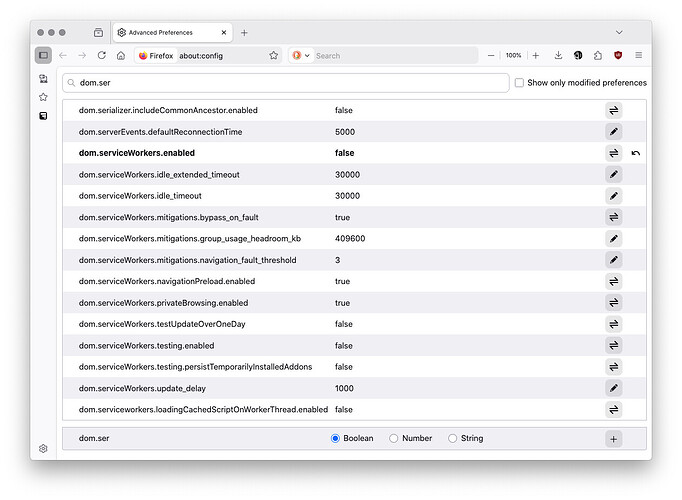

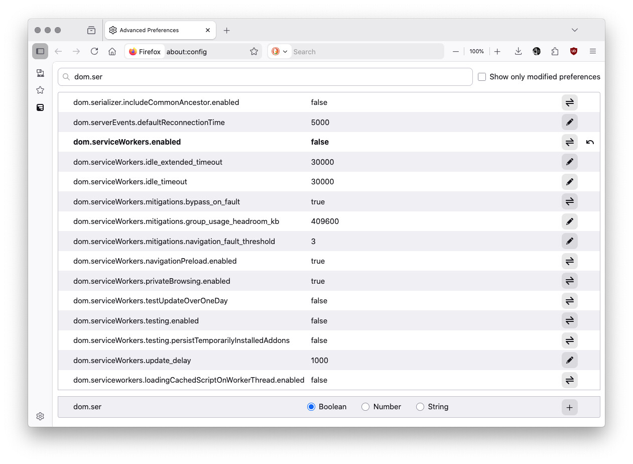

What I can say for certain, is that if you turn off serviceworkers:
(Third line on the image above, only value modified; dom.serviceWorkers.enabled)
The download now completes.
And, who knows? It might save CPU on certain sites that load a lot of sh*t in the background such as YouTube…that, or it might break extensions (still not dev since I began writing this). It can always be undone though.
Hopefully this is useful to somebody. Good luck!
