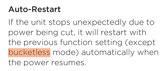

The dehumidifier is actually a beast and has direct drain capabilities. I have mine attached to my AC drain via the bucketless mode.
I could probably get the 35 pint cube to fit where I need it if I use the bucketless mode with a drain hose plumbed to the condensation drain of my AC unit, but from what I can see from the manual, the bucketless setting does not persist if power is lost.
It’s not the end of the world, but I’d have to reset the unit any time there was a loss of power, but it’s annoying.
You should be able to automate enabling the mode when power is restored via automation, you just put in the mode keyword for the profile setting when creating the action.

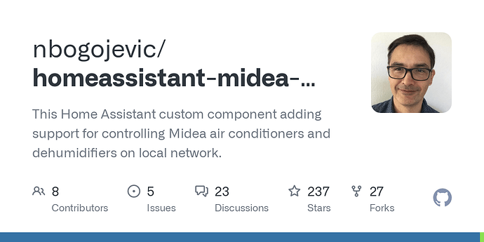

Midea has a subbrand “Comfee”. I use two “comfee den-20-wf” devices and I integrated both with my HA using this midea integration > Releases · nbogojevic/homeassistant-midea-air-appliances-lan · GitHub
