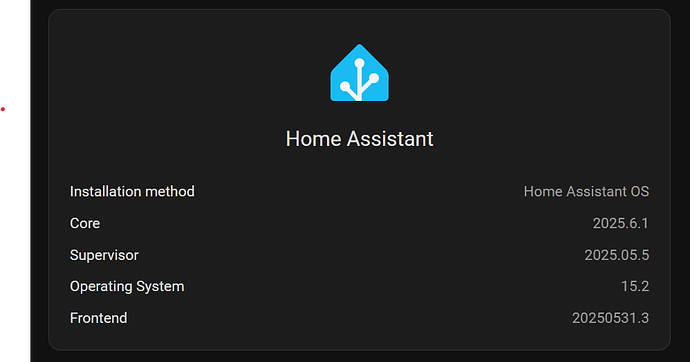

I’m running into the error when trying to upgrade the firmware and now when re-configuring the ZBT-1:
“The serial port is locked by another application”
However, I can’t find any other applications using /ttyUSB0
I’m running HA on a rpi3
