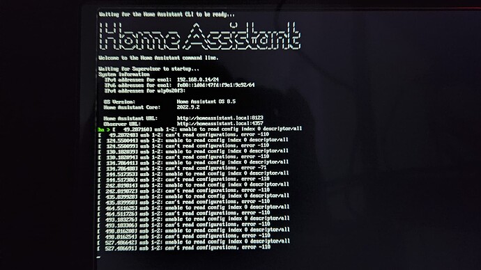

A reboot from the CLI is currently giving me:
Needless to say, the WAF is currently in the negative…
USB connected storage of some form?
No, the only USB connections are the ZigBee and Zwave sticks which have always been there.

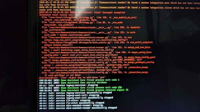

This is the error I have in the core log. Sorry for the photo, SSH is not working so I have to use the CLI directly on the server.
Can you create a core issue for this? I don’t know exactly what’s happening, I am guessing you have a malformed config. If you start posting pieces perhaps folks can spot it.
But even if it is a config error, there’s still a bug here IMO. Broken configs aren’t supposed to crash core anymore. The worst that is supposed to happen is it starts in emergency mode with a big red banner and whatever guidance it can give you on what went wrong.

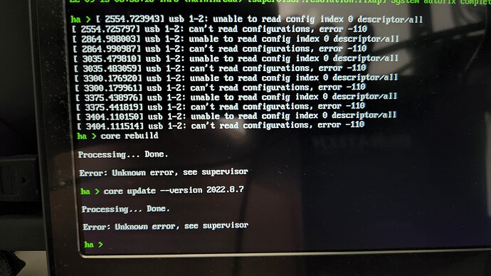

I’m running out of options here it would seem…
I’ve just loaded a fresh boot image to the server (Intel NUC) and rebooted. I’m still getting errors:
So wondering if it’s a hardware fault, however it rather odd that this only started after upgrading from HA core 2022.8.7 to 2022.9.2 and no hardware changes have been made.

This is the log error once again:
  File "/usr/local/lib/python3.10/runpy.py", line 196, in _run_module_as_main
    return _run_code(code, main_globals, None,
  File "/usr/local/lib/python3.10/runpy.py", line 86, in _run_code
    exec(code, run_globals)
  File "/usr/src/homeassistant/homeassistant/__main__.py", line 203, in <module>
    sys.exit(main())
  File "/usr/src/homeassistant/homeassistant/__main__.py", line 191, in main
    exit_code = runner.run(runtime_conf)
  File "/usr/src/homeassistant/homeassistant/runner.py", line 119, in run
    return loop.run_until_complete(setup_and_run_hass(runtime_config))
  File "/usr/local/lib/python3.10/asyncio/base_events.py", line 646, in run_until_complete
    return future.result()
  File "/usr/src/homeassistant/homeassistant/runner.py", line 101, in setup_and_run_hass
    hass = await bootstrap.async_setup_hass(runtime_config)
  File "/usr/src/homeassistant/homeassistant/bootstrap.py", line 138, in async_setup_hass
    config_dict = await conf_util.async_hass_config_yaml(hass)
  File "/usr/src/homeassistant/homeassistant/config.py", line 355, in async_hass_config_yaml
    await merge_packages_config(hass, config, core_config.get(CONF_PACKAGES, {}))
  File "/usr/src/homeassistant/homeassistant/config.py", line 779, in merge_packages_config
    error = _recursive_merge(conf=config[comp_name], package=comp_conf)
  File "/usr/src/homeassistant/homeassistant/config.py", line 693, in _recursive_merge
    error = _recursive_merge(conf=conf[key], package=pack_conf)
  File "/usr/src/homeassistant/homeassistant/config.py", line 701, in _recursive_merge
    if conf.get(key) is not None:
AttributeError: 'list' object has no attribute 'get'
