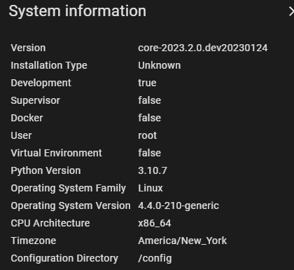

Installation type flags as unknown for some reason
![image](https://user-images.githubusercontent.com/40742722/214638241-306711e3-5e69-46d0-ab4f-8894287aad4e.png)
