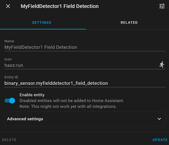

I have a motion binary sensor, coming from an ONVIF camera, that never clears itself.
The parts where it is green are where I’ve rebooted HA or the camera.
It turns out that the camera only sends a event when motion is detected, but never when it stops.
I have a topic about this over on ipcamtalk.
I found this feature request about binary sensors resetting them after x seconds.
MQTT binary sensors have an off_delay setting, which I was hoping to test via the configuration.yaml file with the ONVIF binary sensor.
I don’t know if that also works with a binary sensor coming from an ONVIF camera, that’s what I wanted to test, but now I’m lost as to which config file to adapt ![:sweat_smile: :sweat_smile:](https://community.home-assistant.io/images/emoji/twitter/sweat_smile.png?v=9)
