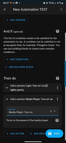

I’m running into a weird issue since a month ago, not exactly sure when it started. When I try to create a new automation in the UI (on the phone app, pc browser, tablet app) the call service action doesn’t display any properties to fill, just the name of the service and no other fields.
For example calling light.tunr_on I can only choose the entity but there is no options like brightness or color, etc Calling a cover.close service…I cannot choose the entity to control.
The same with media player services, can’t choose the player.
U get the picture. …I got some screen captures to better illustrate the problem.
If I edit the automation in yaml.mode and fill out the details manually it works fine.

Hi all !
[Don’t know if it’s the right forum category]

Try to refresh the browser. Most likely something with your browser does not allow the UI to automatically refresh.
Hi, it’s happening on all my devices. Browsers and android apps. I tried to clear the cache and it didn’t help
Have you tried to see if it happens in a private browser session. This seems a DOM issue, so I would try to test in a clean browser session, possibly using a clean system.
Also check to see if you have any firewall rules which prevent JS from executing.
Hi, unfortunately there’s no change. Tried 2 different browsers with ‘private mode’. And i’m not using any firewall between LAN computers as far as I know.
Is there a way to rebuild the database without losing automations and devices ?
Check the server logs for errors, and in the browser open developer tools to check for errors there while you use the automation editor to reproduce the problem. I’d start looking at the console for errors:
Hi, thanks for the ideas.
I opened chrome dev console and waited for errors to appear. I got nothing while editing the automation
I fixed it.
Found the same issue here:
It was a custom HACS mod ‘mini-graph-card’. I removed it and restarted HA and it got back to normal. It’s amazing how fucked up things can get without showing any error message in the logs.
