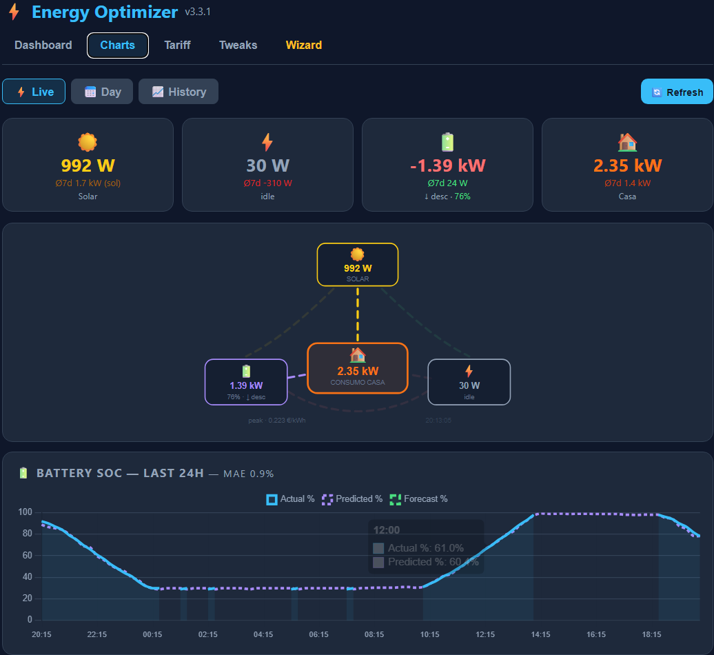

:battery: Smart valley charging — calculates the exact SOC target for tomorrow’s peak demand. No fixed percentages, no guessing.
:sun: Solar terrain correction — if a hill or building systematically blocks your afternoon sun, HA’s Forecast.Solar over-predicts every day. The add-on learns the correction factor from your real production history automatically.
:brain: scikit-learn ML model — a GradientBoostingRegressor trained on up to 90 days of your own sensor history. Features are built dynamically from whatever sensors you actually have — if a sensor is missing, it’s simply excluded. Trains nightly, fully local.
:high_voltage: Animated energy flow diagram — real-time SVG showing exactly where your watts are going at any moment (solar → house, battery → house, grid → battery, etc.), updated every 30 seconds.
:thermometer: Heat pump control — raises/lowers setpoints based on tariff period, surplus solar, and outdoor temperature. Multi-zone supported.
:person_swimming: Pool pump + cleaner — runs during solar surplus or valley tariff to hit daily/weekly runtime targets. Pool cleaner auto-starts with the pump and stops after 15 min.
:gear: Custom loads — add any switch.* entity (irrigation pump, water heater, anything) and choose its scheduling window: valley only / solar surplus / both / custom hours.
:bar_chart: Savings tracking — counterfactual method: what would the grid meter have read without the battery? Priced at your tariff. Honest accounting — suboptimal decisions show up as small negative savings.

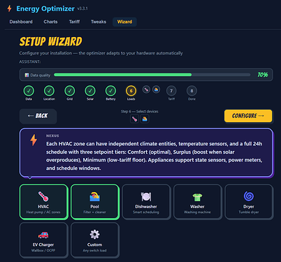

Setup Wizard — no YAML editing required
An 8-step wizard walks you through everything:
Data → Location → Grid → Solar → Battery → Loads → Tariff → Done
It auto-discovers your HA entities using keyword + device class + unit scoring and shows a data quality thermometer so you know upfront whether you have enough history for good predictions.
