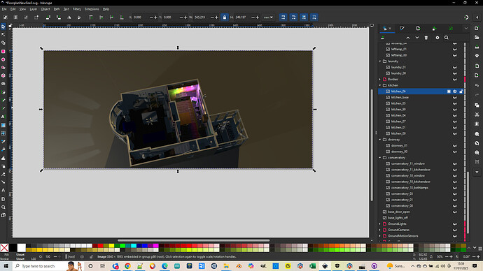

I have set up an svg that has a 3d base view of my house as a layer, and, depending on a sensor that has the name of an overlay layer, it will display the base layer plus that overlay layer. I cannot really find examples that do this so need help with the basics:
screenprints of an example where the base only is visible plus one showing the overlay on its own and then the 2 together, is below:
The following sensor will have the name of the overlay view:
So, if the kitchen_lights_combo_layer value changes to kitchen_06, I want to ensure the base layer (base_lights_off) is displayed and then, over that, the kitchen_06 is displayed. The rest of the house light animation works the same way so I will be displaying a base of each room dark or light, then with the specific sensor layer name selected from the svg.
So I am trying to understand what extra info is required in the svg layer definitions, the css and yaml to make specific layers visible or invisible.
I realise this may involve making a whole bunch of layers invisible as they may have been visible but a sensor change means other layers are required instead.
I have grouped the layers based so that hopefully, I can make all the related layers invisible and then just make the one in the sensor visible.
