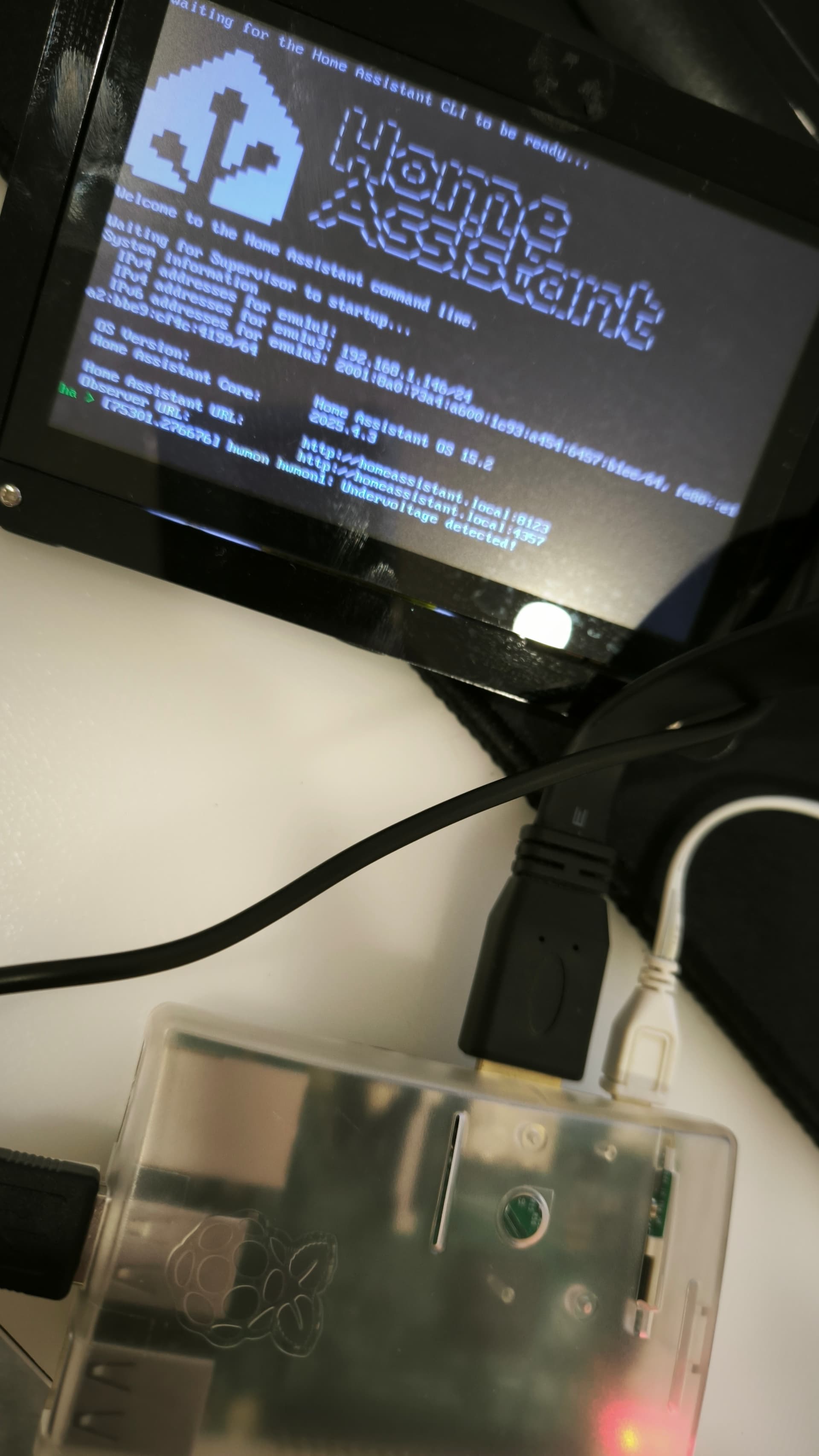

I have HA installed on a Pi and i have a LCD connect to the Pi .
I access HA and fusion on the pc, but i want to view the fusion on the lcd, and control the buttons in there, is it possible ???
I have the page browser made by changing the 8123
But now how can i send that page to the ha on the pi in the way that it been shown on the LCD ???,
Thanks.
Hi, welcome to the forum!
If I understand you correct, you want to have a dashboard on the display that is connected to your HA on your RPi, right?
Well, your HA is a server and it only shows a console.
The server has not GUI.
