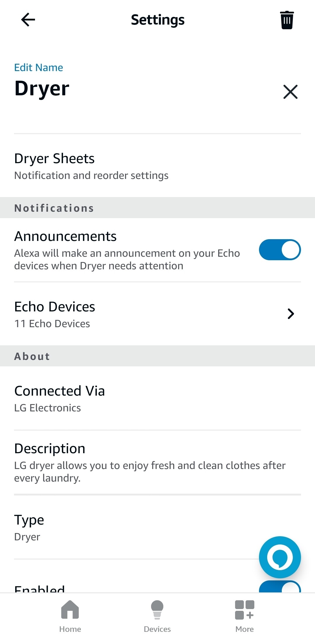

Yes the ThinQ skill in Alexa will support that directly. Just add the skill and look at the device (Dryer or Washer) settings and toggle the announcement button pictured below
